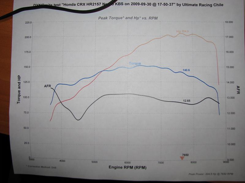

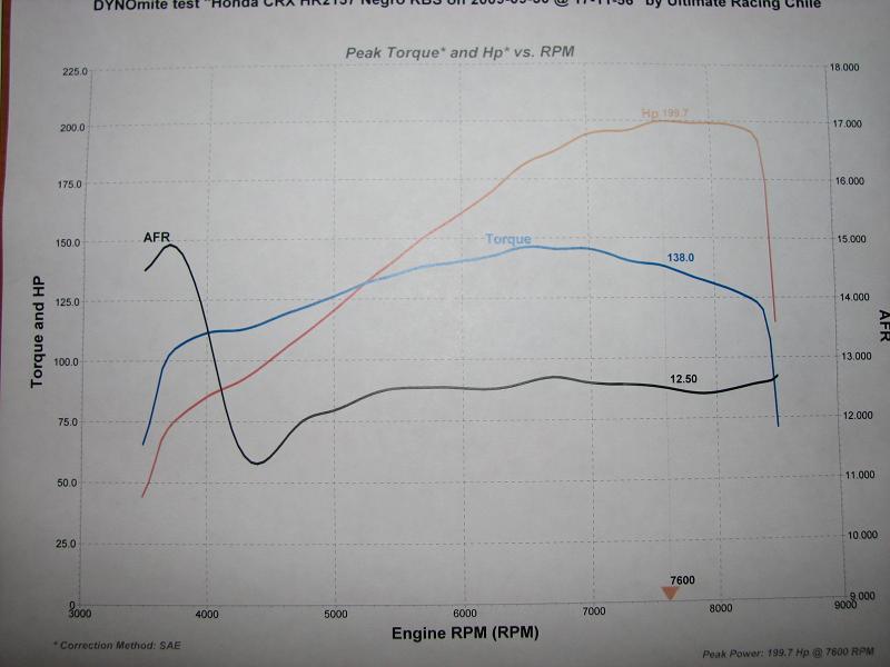

Hi all This is my first tune on dyno with Ectune software, my car has a B20 all motor non vtec, 33 mm intake valves, 12:1 compression Crower cams 405A-2, Type-R Exhaust, Custom Intake, 68 mm throttle etc, p29 ecu... We have made the same setup time ago on a 1.8 B18b P75 head with 31 mm intake valves and free exhaust to the door on 2``, the rest the same setup, it made 199 whp tuned on Crome P75 ecu. The thing is that the B20 dynoed max 204.9 whp on eCtune, very low whp I spected at least 220 whp, at first it made 199 whp and a smooth curve, but when we moved the cams the curves turned on irregular lines... and only 5 whp more... tried every thing, + - timming, + - cams, and the power was always between 199-205 whp... what could be wrong? since I change the cams position the curves become irregular and there is no more power...

This is the sheet with the cams moved and irregular curves...

Im a noob, but I thought all motor setups could run leaner than what the graph is showing? Wouldnt that make more power? MantisX

yeah, but do not trust that afr is different than what my lm2 is reading and it´s taken from the end of the exhaust

so what is your A/F reading for 6500+? what are the timing values? the cal and a log would help.

what kind of header/exhaust setup are you using? when it comes to n/a setup's once you reach up to a certain power level (190-200whp) the key to gaining that extra 10-15hp is in a good custom header and exhaust and fine ecu tuning. also the intake manifold design can play a big factor as well. good power for a non-vtec setup....i like it....

hmm interesting my PLX in o2 bung and Dynojet wideband in tail pipe are like. .1 off. now my plx in the tail pipe end cant read very well at idle but good during a pull. havent put both in the end at the same time might have to try it.

ckretvix wrote:Different dyno, different day?
Same dyno, same day :shock:
