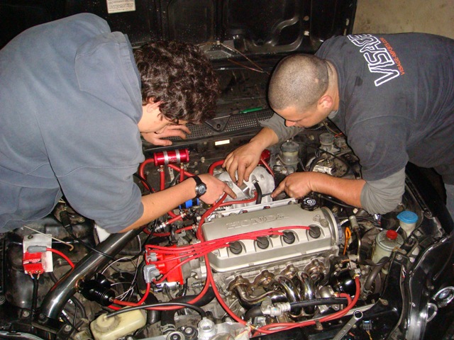

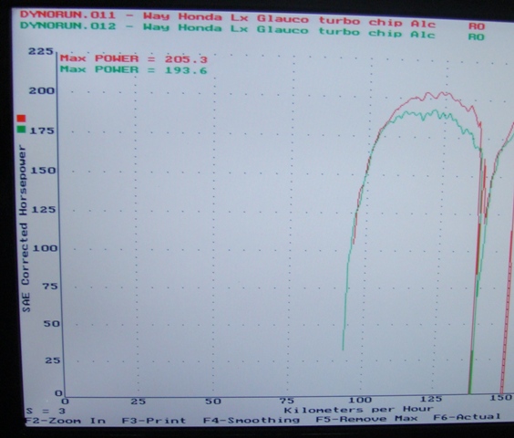

D16Y7 stock internals Y8 IM 780cc precision inj XS Power turbo Kit With Biaggio .42 .48 turbo MSD external coil MSD Cap, rotor and Wires NGK Iridium IX Walbro 255 LPH Downgraded to OBD1 and tunned @ E 85 in Ectune Dwell Time was Tunned to 25deg@ 11.000 rpm and 10.5deg @ 6000 rpm Whith stock Dwell Time car would cut ign arround 6K rpm Setting Proper Dwell timing gave us another 12WHP http://www.youtube.com/watch?v=qjdga2NapTo
