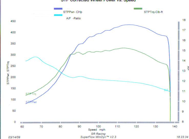

433whp/328wtq @ 27psi stock redline 10-15% low reading dyno. We have had it up to 35psi at the track. We have a built head and a bunch of spare parts for it. If we can keep it together it is capable of a mid 10sec pass. It went 103 in the 8th. Picked up over 35mph in the big end on another pass. Combined with a high 1.6 sixty foot, 10.xx pass. 20psi It went 11.2 3rd pass out with it at a low mph of 126. We added just a two step his sixty foots dropped a tenth. 1.85s to 1.74s Ramhorn 30r, 75mm, 38/50 tial, FJT I beams, 22\" & 24\" slicks Dyno http://www.youtube.com/watch?v=eM1RqUg6t0s 20psi 11.2 @ 126pass 22\" slicks http://www.youtube.com/watch?v=fai4aFDpsDA Were goin back to the track with a built head nice cam and different vitara built block. It has 93/100/110/116 octane maps.

Yea they were morons. They looked at me and said 'looks a little lean aye?\" I just pointed down to there sniffer which had fell out. We had horrible traction issues on that dyno. I'm pretty sure that's what the ripples are from before max tq. If we can put it back on another avg reading dyno, w the new head/cam, higher rev point and more boost. All of which we have done it will be the most powerful vitara in the world. It current record is 478 set by JFK, I'm pretty sure I wouldn't have a problem busting 500hp with this setup. I just need to hurry before someone else does.

Yea tell me about it, the dyno operators were ratards, I asked them to overlay tq graphs to tweak the timing and they looked at me like I was retarded and said I should be using a knock sensor.
