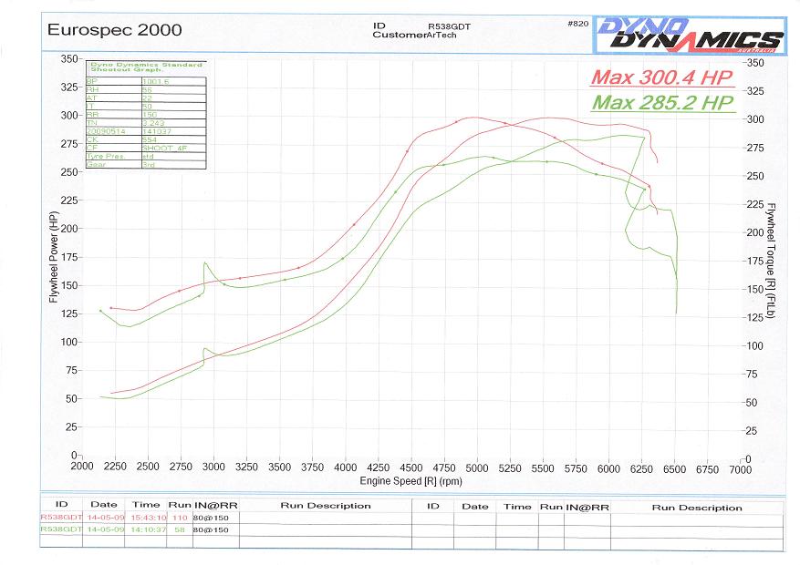

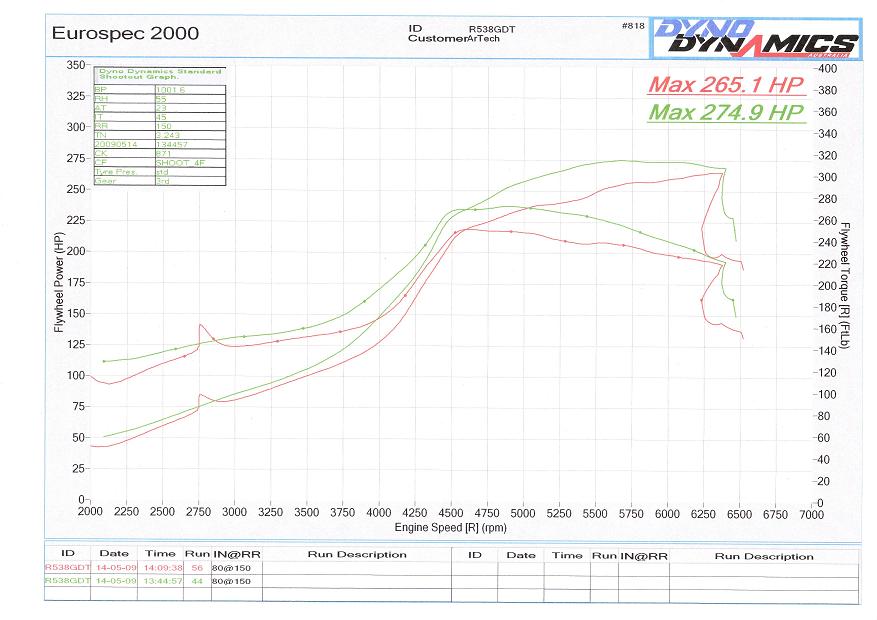

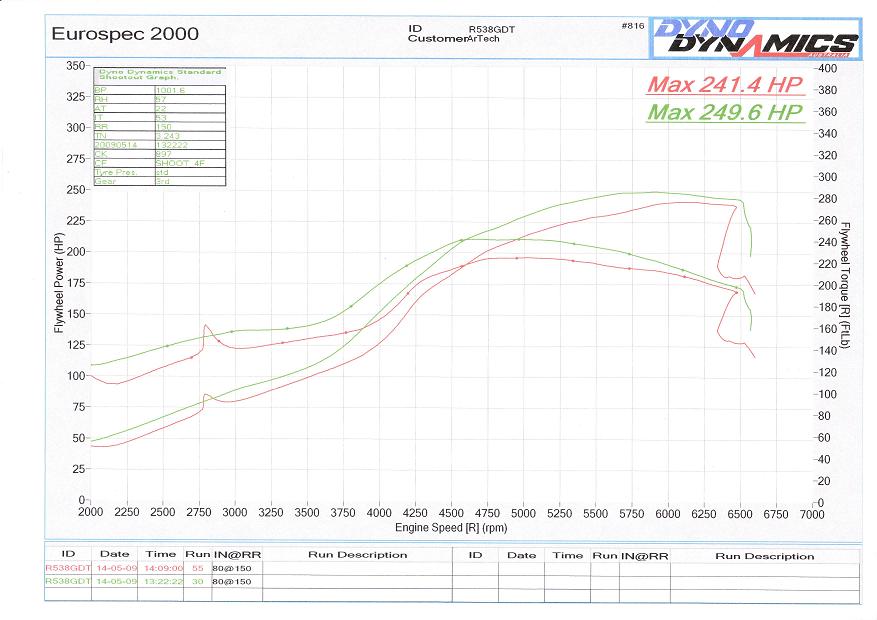

Honda Accord 2.2i SOHC (F22Z2) Wiseco 8.8:1 Forged Pistons CAT Power Super H Beam Forged Rods ARP Headstuds Turbonetics T3/T4 Turbo V trim stage 2 .48 51 Lbs/min Turbonetics Evolution wastegate Turbonetics Raptor BOV Apexi Power Intake Treadstone cast manifold Treadstone TR8 intercooler Treadstone 2.5\" Intercooler piping Custom 2.5 inch stainless downpipe kit HRC Racing 255lph Uprated Fuel Pump HRC Fuel Pressure Regulator AEM Tru Boost Contoller 440cc Lucas Injctors Iridium Spark Plugs 3\" Decatted S/S Exhaust Remap before with crome by another Tuner Remap now with eCtune The customer came because he wasnt too happy about the driveability on decelaration and had problem on cold start as well with crome but apparently the power was ok He's more than happy now as the cold start is not a problem anymore, the driveability is much better and the power a bit better ^_^ Thanks again eCtune, it was the first time I remap a F22 and I was quite impress about the torque it made :shock: You can see the difference before and after (crome VS eCtune) 7psi 10psi 12psi

Excuse me but how can I see the difference? p.s. Sorry after I replied the pictures came up. Looks good over Crome :)

VTEC Inside wrote:Excuse me but how can I see the difference?
On each graph you got 2 differents curve The lowest one is the crome one :wink:
