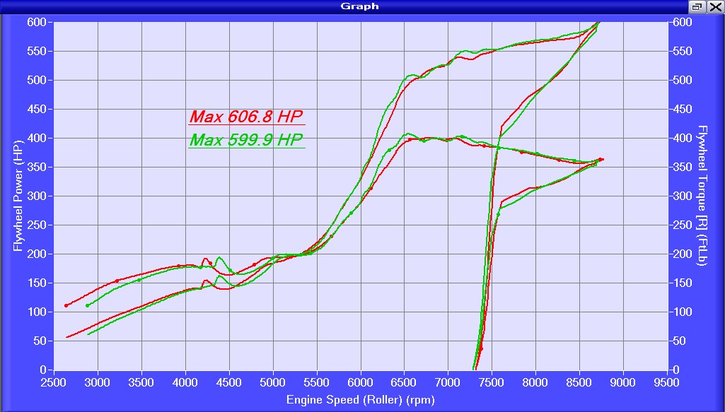

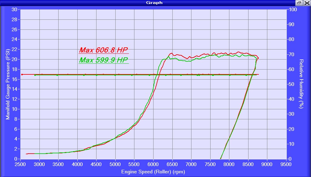

This a repeat customer, made a measley 286whp on Mustang Dyno a few months back on eCtune but went out the next week and ran an 11.2 @ 125 with 22\" slicks on that tune so he wanted to go bigger. He picked up a killer deal on a block and put this together. The setup: Darton Sleeved LSV, 84mm, CP 9:1 and Crower Rods Stock GSR Head (no porting) Full Ferrea Valvetrain CTR Cams (no cam gear adjustments) Precision 1600cc Injectors, resistor box (no drivers, ugh) AEM 3.5 Bar Map Precision 750hp FMIC Peakboost Ramhorm T3/T67 Turbo Full C16 race gas Timing and AFRs were very conservative, customer showed up almost 3 hours late so my time was cut down...I would have like to have done more. Boost was at 21 psi, and could have gone much higher...he may come back for 30 lbs in the near future. This was a very efficient setup.

damn, nice numbers.. keep up the good work, cant wait to see it at 30lbs
Wheres the dyno sheet of this 600 hp beast :0 its like saying my gf has DD tits without a pic :)
