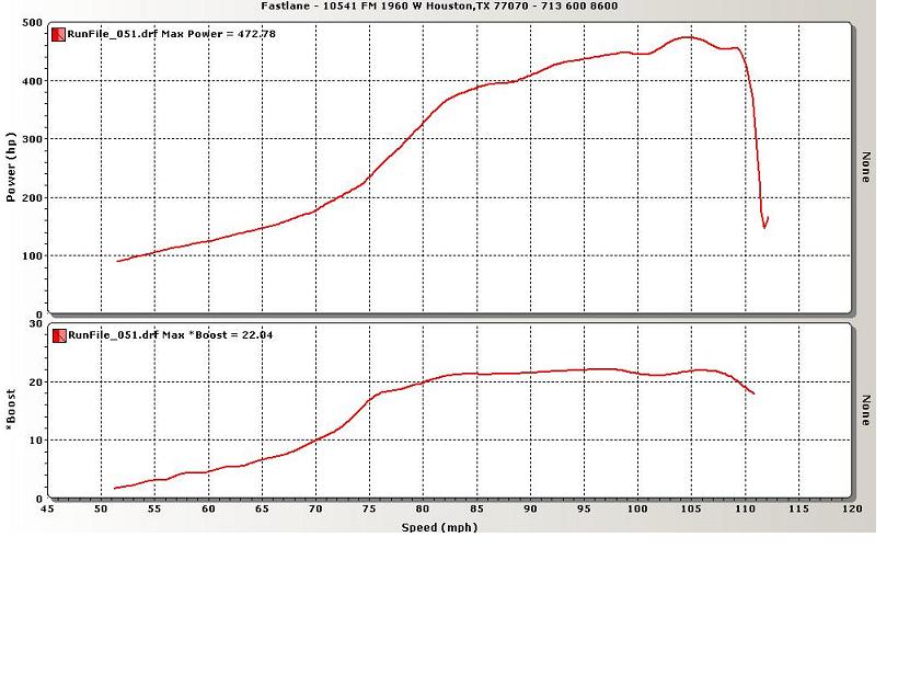

Turbo LS/VTEC 472 @ 22PSI not fully tuned out.
Stock sleeves forged pistons and rods, SC61 turbo on a FR topmount. Q16 race gas. Sleeve cracked before I got to finnish tunning out the timing.. Motor was already sick & tired, we were hopin it would hold 500HP for 1 race, but it poped on the dyno.
