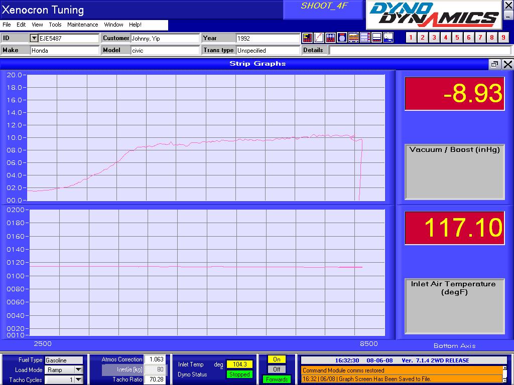

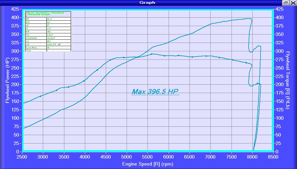

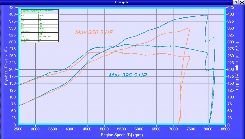

Fucken axles still giving me problems...I got the driver's side warrantied (thanks DSS) but the pass side is grinding on me still. I thought it might be the tie rod being goofy on that side so I replaced it, replaced the upper arm on the drivers side as well as that ball joint was toast too and put in the new axle. Here are some updated numbers...I havent increased the boost at all but it is running slightly higher. The only changes here are a new secret version of code from Calvin and a 68mm throttle body (swapped out the stock 60mm h22 TB). Wow....what an improvement.

i want h22-t :( whats your AFR from 7-8k what is the secret code you speak off :twisted: you should have changed JUST the TB, ran everything else the same, and saw how much HP you gained off just the TB. Would have been cool to compare!
combz wrote:i want h22-t :( whats your AFR from 7-8k what is the secret code you speak off :twisted: you should have changed JUST the TB, ran everything else the same, and saw how much HP you gained off just the TB. Would have been cool to compare!
I dont think the code change made any difference in power...I think the gains were from the 60mm to 68mm upgrade. AFRs are roughly 12.0 at 10 psi...11.5 at the 13-14 psi.
