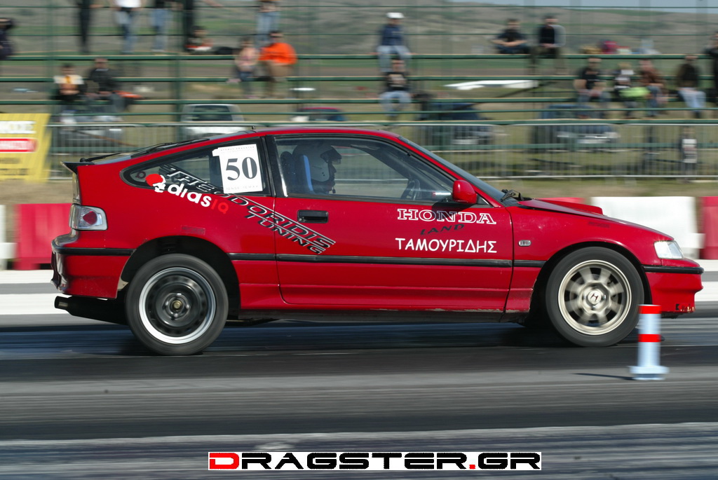

273.5 HP and 30.6kg TQ
nice, with that much power on tap, if you get the car too hook and get it light enough you should be able to pull low 11s, my buddy runs 11.40s on about 260HP.. Hes has less TQ than you though, hes running 86X89 in a B16 block with custom rods and pistons.. another friend of mine ran 12.0 with only 248HP, so you WILL run 11s, if you get everything setup just right.. :D

Yes, lots of traction problems.

Well right now i'd really love to hear opinions on suspension setup... Traction is BAD, we did a 0-18m 2.12, if it goes to 2.00 that will definitely help... My ears are open.

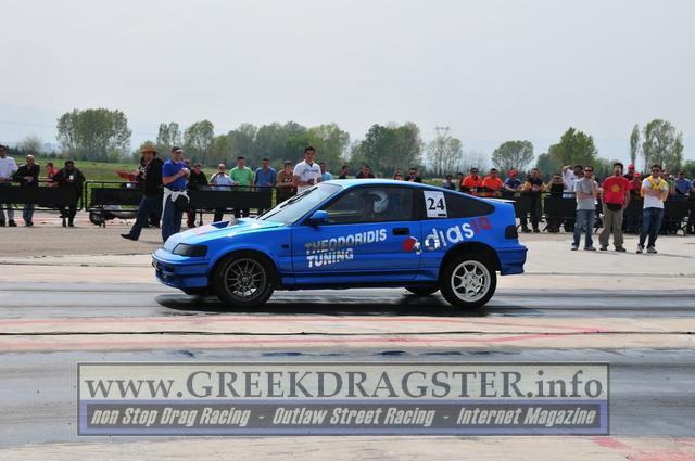

Last update on this car. We got the Championship for '08 best time at 1/4 mile 12.51 with 187km. THANK YOU Calvin. This year new engine. Stay tuned.

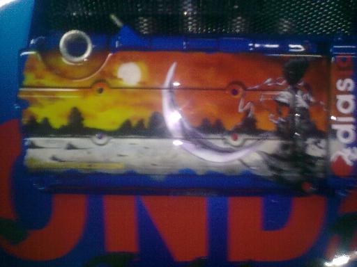

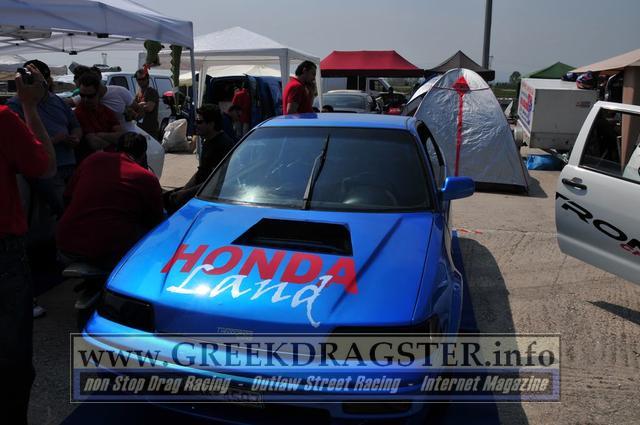

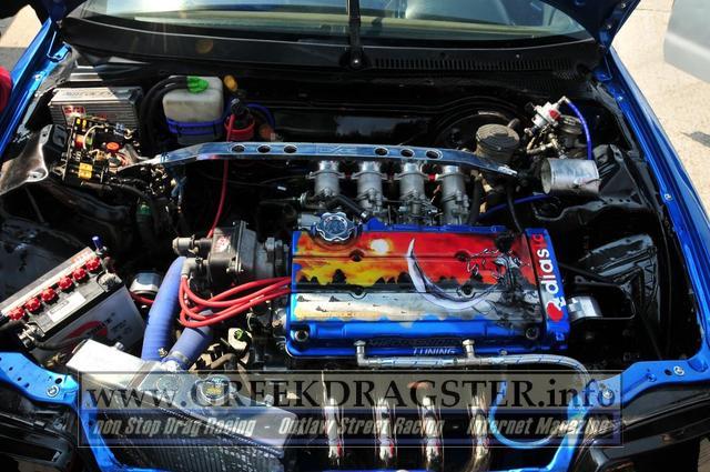

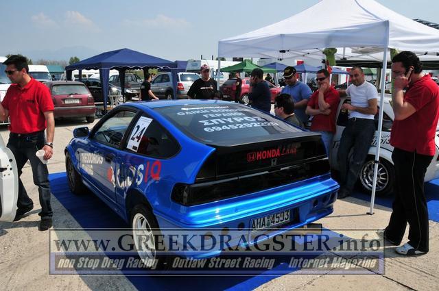

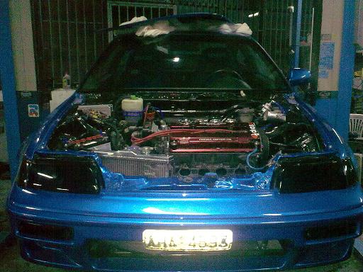

New pics.... Car is completely changed. New color, new engine.... More and better pics are to follow. With this new setup car made 312hp and 29.8kg of torque... Bad thing is we came third due to my driver losing a gear Best ET 12.3 with 188km/h ....
crx small.JPG (52.95 KiB) Viewed 12765 times
valve cover.JPG (30.95 KiB) Viewed 12765 times
ge0ne

More...
9400RPMS
Posts: 209
Post by 9400RPMS »
all motor guy here myself nice specs.. seems alittle over kill on four widebands but hey, whatever works for you bro ^^ Why do the bearings need to be replaced and why go with crane? I've had nothing but bad problems with crane in the past, as well as quite a few others.. i had 2 of their sets snap on me.. any problems so far?
