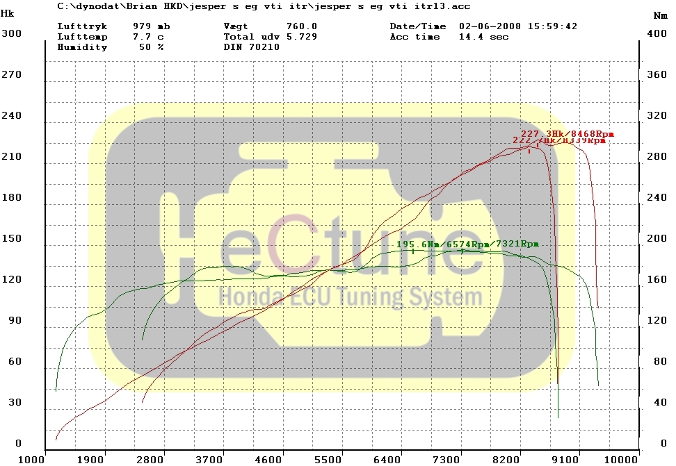

Stock bottom end, blox cams. Some high revving cam gear, not sure which one. Anyways, the dyno sheet shows the original tune I made, compared to the new and improved one done when the owner figured out that the cams were set to the wrong degrees. One cam was moved back froim +4 to +2 in accordance with the specifications from Blox. Oh, and we found out there was some nice cam gear in there as well, so I moved up the limiter a bit. Sounds awesome (K18 sound!) when using ign+fuel cut! :D Doesen´t look like much of a difference on the dyno sheet, but made a big difference on the street. Yet another satisfied eCtune customer. /Allan

Every eCtuned dyno graph should have a logo on it. :D Made in a couple of minutes in The Gimp. /Allan
