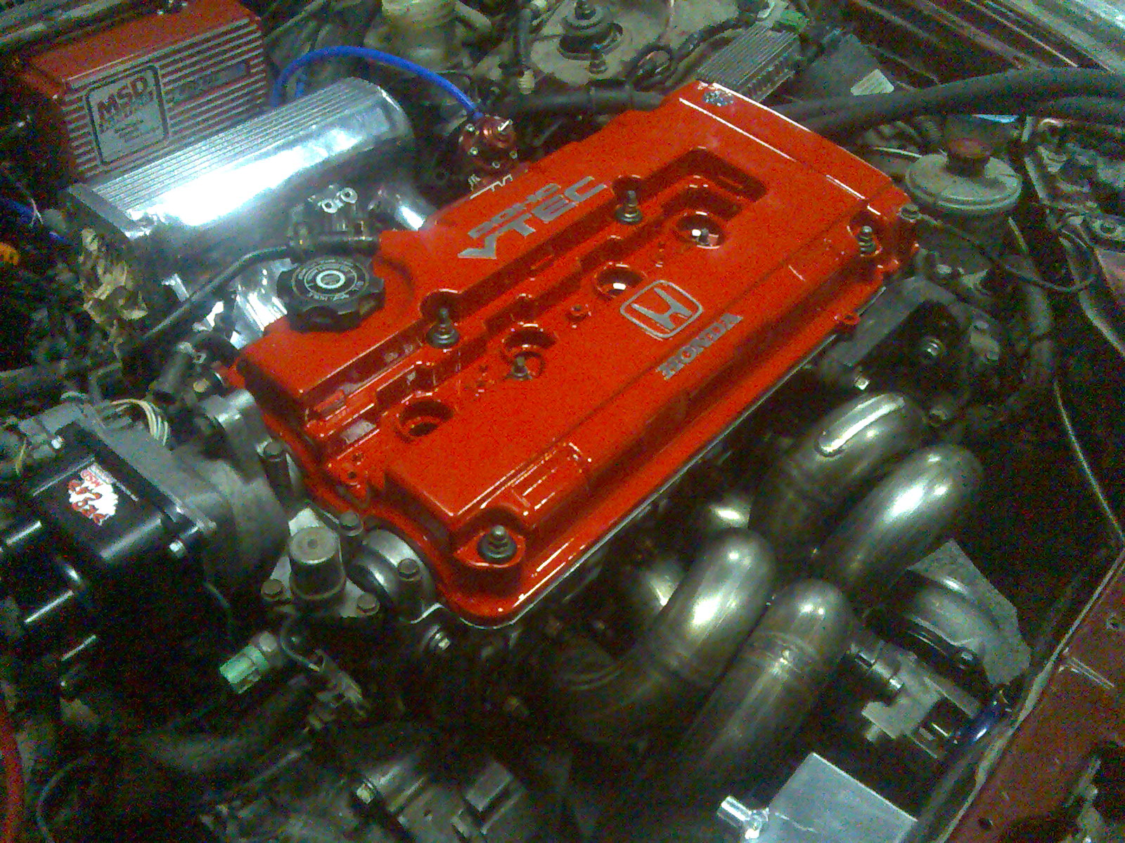

It was time to post it, a few months ago, i tuned a turbo EK B16. Car made 602hp at 8670rpm and 52.3kg of torque at 8182. Only that we couldn't measure it till the rev limiter cause it continually spin on the rollers after 8600... Rev limit is at 9600. Car runs on 2 bar with an 60-1 and is fully built. 84mm CP pistons Pauter rods Darton sleeves Crower cams Full Ferrea valvetrain Port and polish Ram horn Manifold 3'' exhaust Turbosmart external 1000cc injectors Prodrive 280lt/h pump Aebs I/M Precision I/C MSD 6AL Ignition Big thumbs up also go to Xenocron, for making lot of this parts come in Greece in time ;)

I know you would be interested, car will hit the track at september. But not much expected due to its weight (car is a 4 door). Either way after some secret test results car did a 12 sec pass with 220km/h exit on the 1/4 mile :)
