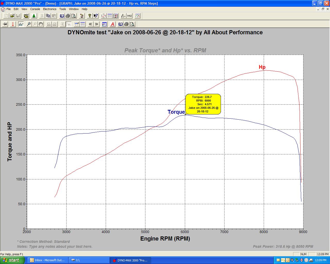

Engine- 90mm H23 block. Sleeved by RS machines Billet 102mm Crank Custom Cunningham Rods 15:1 CR JE pistons H22 head ported by Portflow Ferrea Valves Custom Grind Crower cams Crower springs/retainers 52mm TWM ITBs portmatched to head 550cc injectors Ericks Racing Header Kaizen Speed Balance Shaft Removal kit Hdata Intake Manifold Gasket Q16 VP Fuel NGK 9 heat range Non-Proj Gap 30 Trans- Civic Type R trans with factory LSD 4.7 Final Drive Rims and Tires- 13x7.5 Lensos 24.5 x 9 Mickey Thompson Slicks Suspension - Kyb Shocks Ground Control coilovers
good job randy thanks for sharing the cal too
I love H22 motors and hate them at the same time. So torquey and so touchy :) How come you arent activating VTEC earlier...it seems like it wants it?

I accually did lower it to 4800rpm on friday. It did make the power come in earlier. no real change to the overall. On another note the engine droped a valve on saterday at BOTI Maryland. We will be rebuilding hopefully the block is ok. Piston in #4 is a bad and the head took a big hit. Rev limit was set to 9200 and we were accualy only shifting at 8200.
