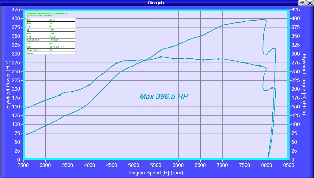

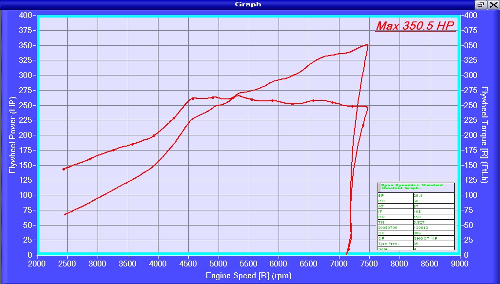

I am going to use this thread and update as we go. As some people know, I like doing things in stages rather than just trying to extract 4 million horsepower on the first dyno session...so I have been building this H22 motor very meticulously since we melted down a piston last year and I think she is ready for the track so I am probably going to go this weekend :) Threw here on the dyno after working out all of the kinks...and in two pulls only, made 350 at only 9psi...gotta love having 250 ft/lbs of torque from 4500 to red line. Oh...and a coupler popped off at 7500 rpms...we were revving to 8k on this pull. This setup should carry power nicely to 9k or higher I am hoping. Setup is as follows: - 88mm Golden Eagle Sleeved H22 open deck - Wiseco 8.5:1 Pistons - Pauter Rods - Mike Belben Ported and Worked H22 Head - Supertech Dual Springs and Retainer - Ferrea 6000 Series STD Size Valves - Skank 2 PRO 1 Series Cam Shafts degreed in with the Belben Cam Fixture Kit (which we now sell) - 1Fab Shitty EL Manifold, Rewelded and Heat Coated - Garrett GT35r, .82 AR - Precision 750 Intercooler - Precision 1000cc Injectors - GM 3 bar - Walbro 255 HP w/ Aeromotive -6 FPR and GE Fuel Rail - 68mm Proessional Products TB (Stock Throttle Body) - Stock Intake Manifold with IABs removed (no porting) There's a bit more...but needless to say I'm happy after today. Let's see what she runs low boost at the track. The plan is to make 500 on race gas and run mid 10's which should be doable...nothing crazy :)

Nice setup Chris, I like your approach on things by taking your time to figure and find things out with a lot of testing and tuning. Keep up the great work.
i love that turbo! that tq curve is sick!!!!
That is a really nice power band. Can I borrow it to go round the Nürburgring? :D /Allan
Bindegal wrote:That is a really nice power band. Can I borrow it to go round the Nürburgring? :D /Allan
Sure thing Allan, as soon as they build a bridge across the Atlantic and I will drive it over :) Track numbers coming later tonight...low boost.
