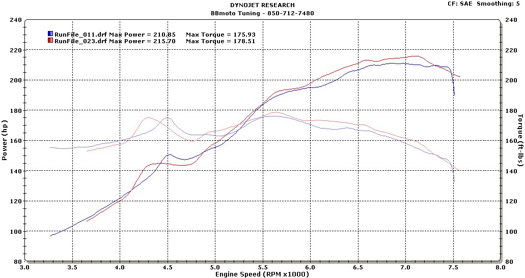

Image 12.2:1 RMF narrow 3\" exhaust EuroR IM RDX injectors (55psi) AEM CAI with BPi flowstack s2000 throttle body COMPLETELY stock h22a head I am SOOOO glad i learned how to read the spark plugs. Before i even get into it, i want to thank Chris. You opened up a whole new world for me tuning wise by your post on reading plugs. My power jumped dramatically by adjusting the individual cylinder trims and then adding timing to the maps. I was short on money and ran out of time before i could keep fine tuning. You can tell there is some more to be gotten out of it by the random peaks of power. There was just so much to do with such little time. everything about the ignition maps changed once i started doing cylinder trims and its just amazing how much that effects the efficiency. I ended up pulling 3.5* from cylinder 3 and 3* from cylinder 4 and .5* from cylinder 2. Each time i made a correction with that and made a run, the power dropped and got choppy automatically making me think \"add\". If i had more time to do that through the RPM range, i believe i could fix many of the dips.

Crome fully tuned vs. eCtune partially tuned
Wich color is what?
red = eCtune blue = crome
eCtune > CROME... Even I figured that one out *snickers*
Looks good man, glad the timing stuff worked well for you.
Bugermass wrote:Looks good man, glad the timing stuff worked well for you.
thanks Chris, it really does bring a whole new meaning to tuning. Its nice having a tattletale :P
haha, dude so many ppl have helped me and told me little secrets and ansered my somtimes dumb questions and what not, I have no problems sharing with other tuners.
