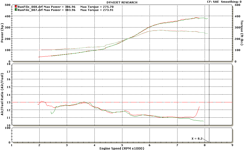

sheet. Sorry for AFR being so big... I was in a hurry to get out of there. Also notice smoothing is set to ZERO. As you can see, its still a very conservative tune. First run was 338whp on street tune that was even more conservative. With the extra 48 whp, I'm hoping the car traps 126-127 instead of 123.
shitty dyno graph
shitty dyno graph
nice power!! VTEC looks like it could be a bit lower, but it wont make a big difference. launch that bitch at 8K!
