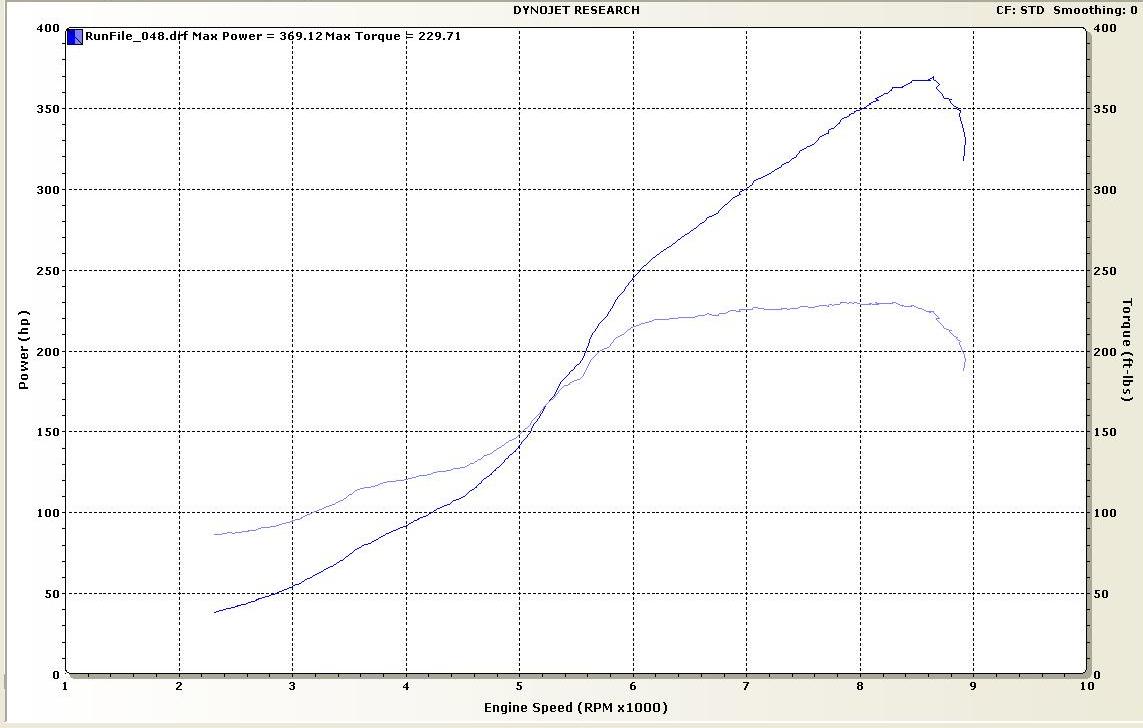

B16A, T3/T4, 369hp/229ft-lbs
B16A with rods and pistons, T3/T4, RC 750CC injectors, 17 psi on pump 90 octane

WOW very nice. Do you have any log? is it possible to post the map and datalog? im new to tuning and want to learn to tune boost
no logs saved and sorry can not share maps.

where did this motor hit full boost?
my guess is ~5500-5,800 RPM =)

how did you tell from looking at the torque curve? where it starts to straighten out?
