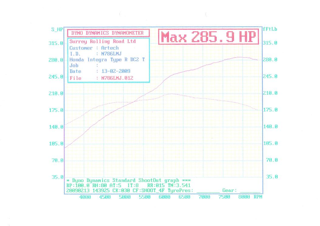

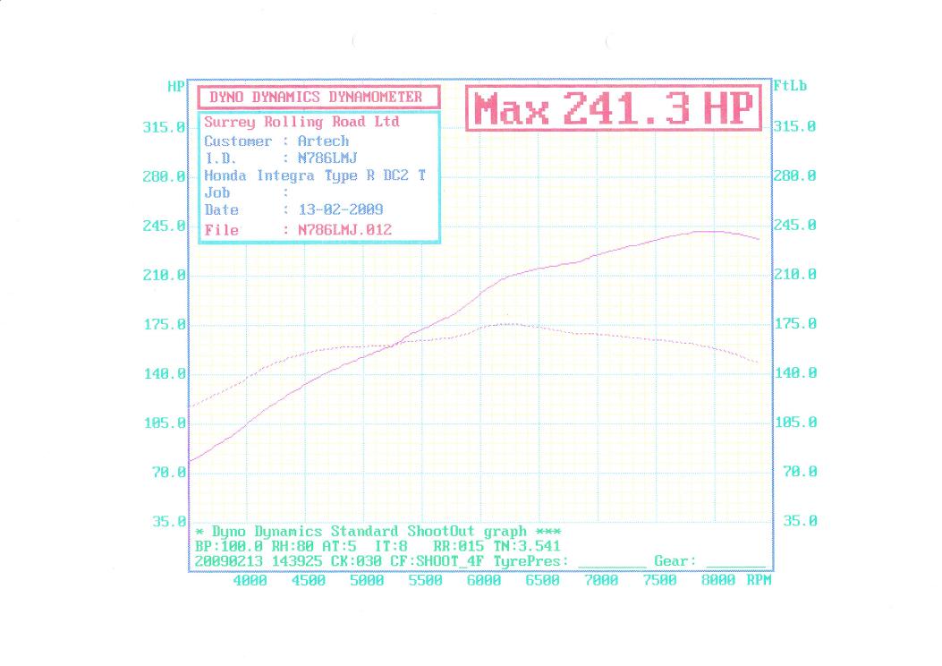

Stock B18C jdm ITR engine RC550 injectors Walbro 255lph fuel pump Sard Adjustable fuel pressure regulator (set at 45psi) XS power T3/T4 turbo (shit but cheap) OBX front mount intercooler Blox cast manifold Tial 38mm wastegate (with 7psi spring) SSQV blow of valve (HKS copy) 3\" downpipe and exhaust Its the first time I tuned a DC2 turbo with eCtune and as usual its great I just love it :P
DC2 turbo_0003small.JPG (67.33 KiB) Viewed 4140 times
DC2 turbo_0002small.JPG (69.68 KiB) Viewed 4140 times
DC2 turbo_0001small.JPG (69.02 KiB) Viewed 4140 times

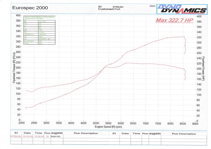

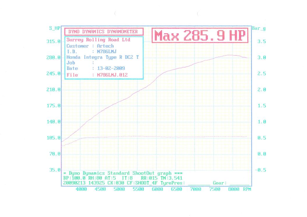

New Turbo = New map A bit more pressure as well (.7 instead of .5)
DC2 Turbo small.JPG (72.42 KiB) Viewed 4038 times

nice torque
