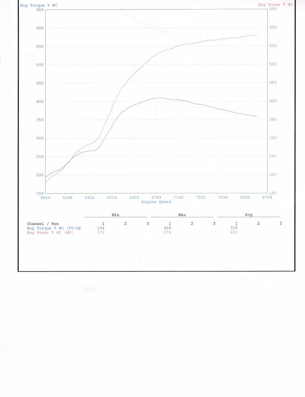

Had some fun on the dyno last weekend before I broke the teeth off of 4th gear. I just rebuilt the trans over the winter with new gears from Honda and had them heat treated. Looks like I will give the Mfactory gears a try and head back to the dyno.. 84mm LS Vtec Stock type R head with inline pro springs/retainers stock gsr throttle body and cam gears Inline Pro GT37 non ball bearing turbo kit Bosch 1600cc injectors with resistor box 2 bosch 044 fuel pumps fed by a custom surge tank mounted in engine bay 4bar map sensor mounted in stock housing E85 winter blend $1.76 a gallon!!! Ectune 30psi - 579whp :P Special thanks to Vernon at Raver Motorsports for all the recommendations and tech support and of course Cavlin for the awesome software!!! Still have more tuning and boost!! My goal is to run low 10sec quarter miles on $1.75 fuel and a stock b series head

Ran the car at Island Dragway in NJ on Sunday... Only 27psi of boost. I did have the car at 32psi on the Dyno making 597whp. I had it turned down so the stock gears in the tranny would hold up :) Enjoy! http://www.youtube.com/watch?v=zH1Dm9IbGQc

great result on a Mustang dyno!!! 8)
