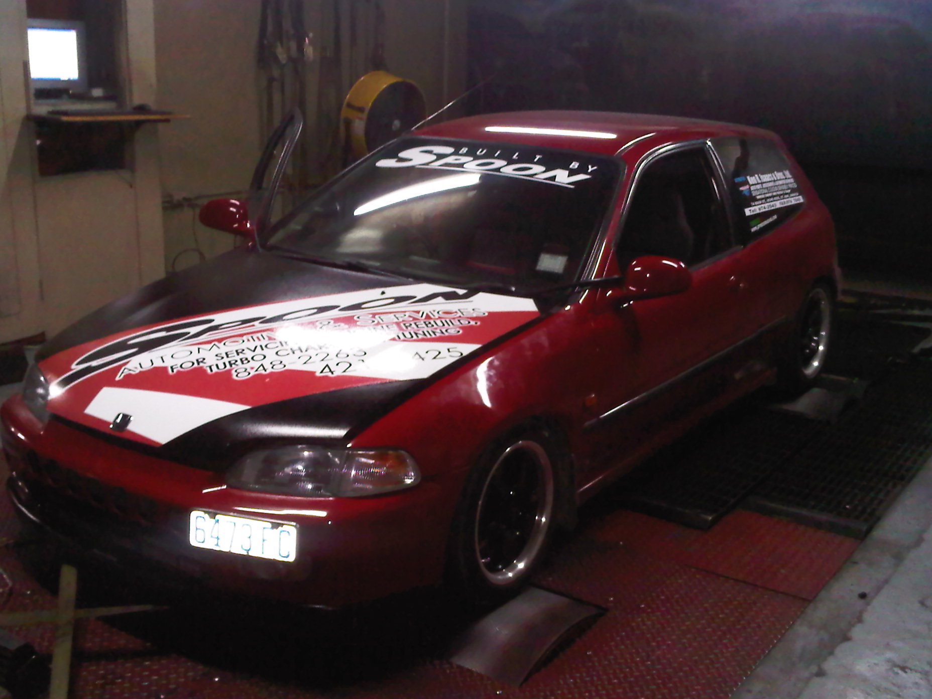

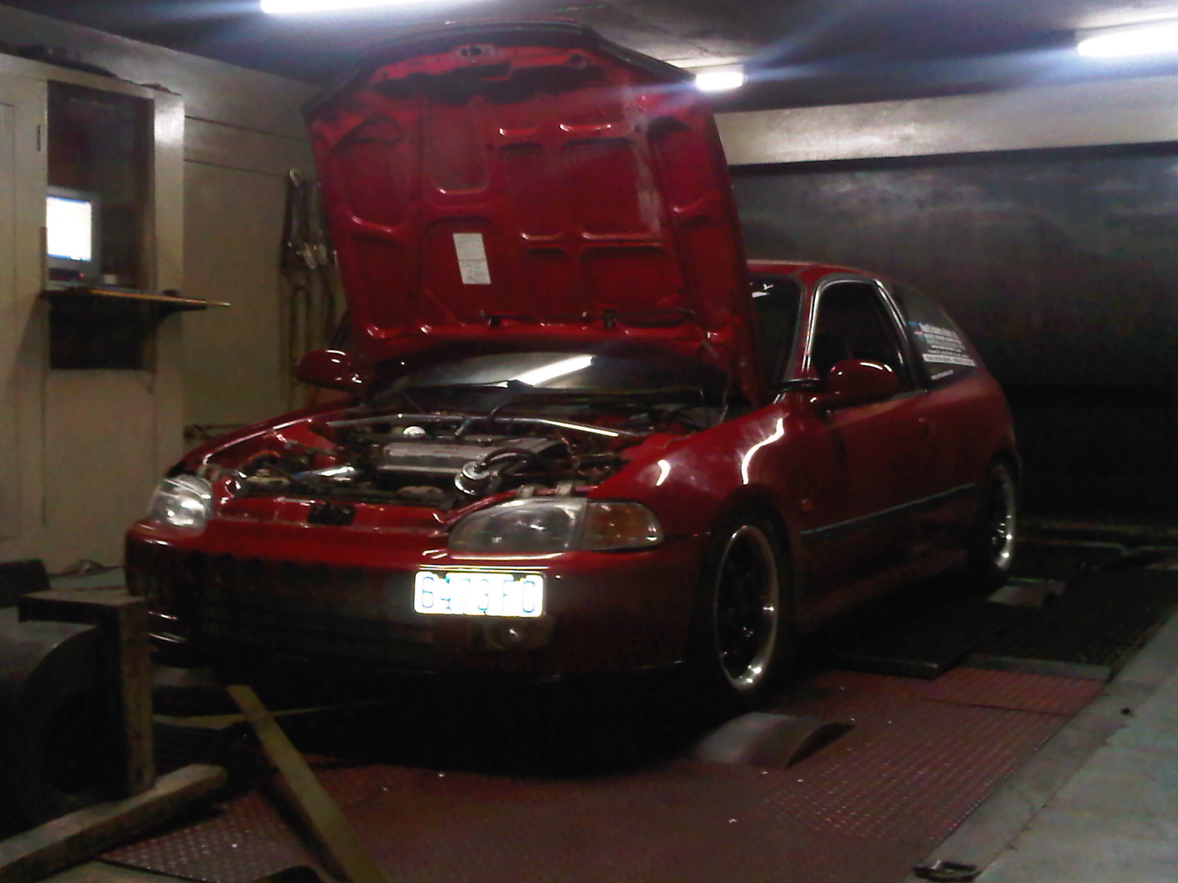

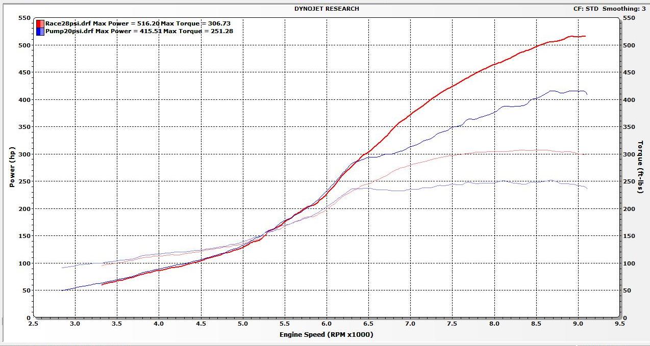

Tuned a B16A stock bore with rods and pistons, typeR intake manifold, 1000cc injectors, inhouse made exhaust manifold, with 35R Car was built by the owner who is known here in Jamaica as \"Spoon\", who runs a shop in Ocho Rios. Made 415hp/251lbft @ 20psi on pump 90 octane Made 516hp/306lbft @ 28psi on Q16 Set up is a bit laggy, boost was coming on late, and we were using a manual boost controller. But none the less the owner was satisfied that he made his goal of 500+whp.

some pics of the car. Previous the car has ran a time of 11.9 with 390hp full interior at a local track \"JamWest\" here in Jamaica. Owners plans to revisit the track this month to see what the car can do.

im not hating, but damm those torque numbers are low on the pump gas eh? at 235whp on my stock d-series on the gt28r i had 229 ft lbs of torque. b series :lol: jk :P
combz wrote:im not hating, but damm those torque numbers are low on the pump gas eh? at 235whp on my stock d-series on the gt28r i had 229 ft lbs of torque. b series :lol: jk :P
lol...yup they are low the 35R setup used was really laggy. But the car feels great on the road :twisted: FYI .... the sohc's have a stroke of 90mm vs the 77mm of the B16 that is why the sohc are so full of torque :wink:
