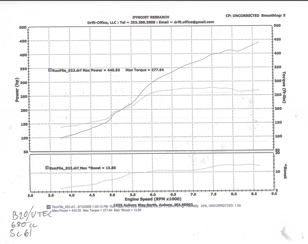

B20/vtec 440whp 278trq 13.8 psi
Post by FACETUNED »
B20/vtec Eagle Rods / Arias pistons. 84mm ported b16 head. Ctr Cams Ported JG edelbrock victor x 70mm TB Equal length Ram horn. Precision sc6162e 3\" open DP Tial 38mm Dump tube under the pan. 32x12x3 Intercooler 2.5\" Charge pipe GM 3Bar 680cc injectors single walbro fuel pump. pump 92 octane 13.8 psi

I know it's old thread but ... I'm building B20B block with B16 head for turbo and will be installed in '92 Civic hatchback converted to AWD and I was wondering how much is safe with stock sleeves? I will install block guard and/or block posting as well. Or should I resleeve the block. I'm talking for 400-500hp. Thanks! -Mitko
