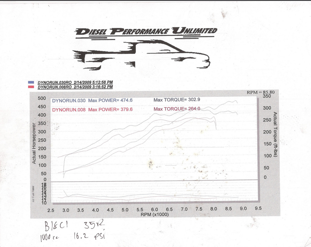

475 whp 303 trq
Post by FACETUNED »
B18c 84mm Eagle Rods / cp pistons Jg B16 Head Ctr Cams Edelbrock IM 70mm TB PTE 1000cc Dual Walbro's pump gas 92 GM3bar PWM eCtune boost solenoid Mini Ram manifold GT3582R 3\" Down pipe / Full exhaust Tial 38mm / open DT 16.2 psi creeping a little. Its on winpep 6 so it looks a little jagged.
