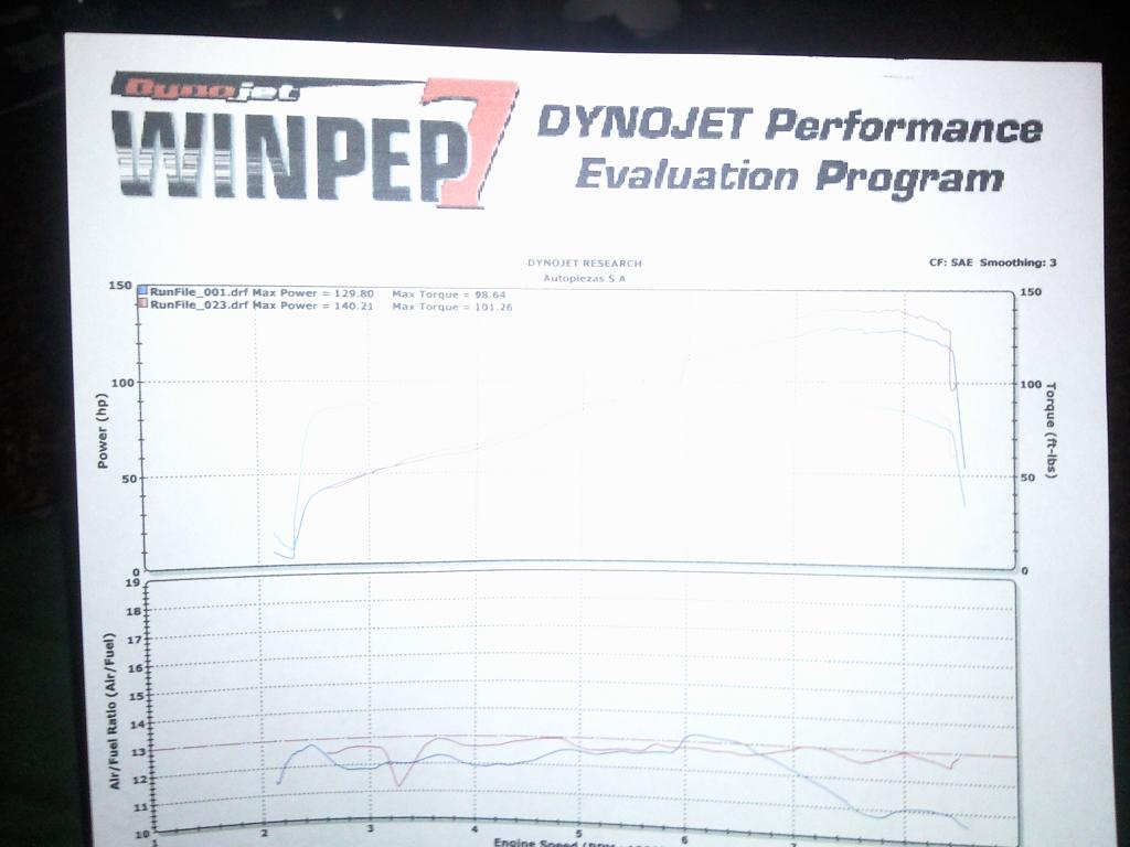

this is the picture of the dynotune we gave my friends eg6 jdm, today i duno if its low hp but guys with hondata seem to be geting lower numbers, it only has an exhaust, and intake, no headers or any other thing

i forgot were at 5500 ft above sea level and here is the cal

Funny high cam timing map... Does it want that much timing between 4500 and 7000?

ran out of time,was getting issues with the throttle cable it didnt line up properly, was starting to get the fuel to a decent level, ill try and get some more time, and go with better plugs
