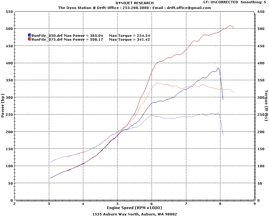

simple setup b18c1 - eagle rod / wiseco piston 81mm gsr head / ctr cams skunk2 IM/TB 2.5\" charge pipe Facetuned tuning mini ram. PTE sc6162s 3\" full catback PTE 1000cc pump 92 oct. 22-23 psi. dyno graph is from wastegate to 22ish psi. 8)
Stock sleeves? Care to share the map? Nice numbers! I'll see soon how my s366 likes 23psi on 93 octane. I love to see people pushing further on pump gas, that's great!
nice setup and great HP! i just finished tuning my friends similiar setup last night: Stock sleeve GSR Motor 9:1 JE pistons, Crower Rods Stock head S2 IM, Stock TB PTE SC6162 3\" Full exhaust 750cc Precision 600hp intercooler Crushed bent 2.5\" intercooler piping. Car made 424whp on 19-20 psi only reving to 8K rpms. If i could have reved it another 500-1K rpms it would have picked up another 20+whp. Over the winter we're going to redo the intercooler piping, bigger TB, Bigger injectors, Type R or S2S1 cams, Springs and retainers to rev it to 9K cuz power wasnt falling off. What kind of timing were you running on pump? 1st i was at 12* and it was barely touching 400whp. turned it up to 14* and it made 424whp. plugs looked good so i left it like that and didnt go up any further with timing.

Without the meth kit they produce about 320whp/340wtq on pump gas. Its a nice autox turbo, DD as well...but still drops off pretty hard up top. I want to see this turbo on an sti with Cams....
