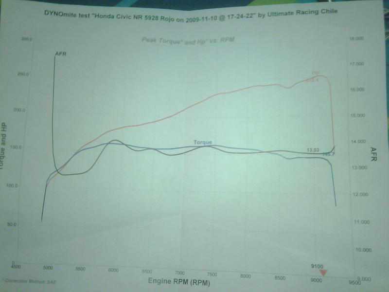

B20 w/ killer vtec P&P Head / stock valve size 13:1 CR Performer X intake 68mm TB / Tri Y header 252 whp@9100 rpm, runs fine up to 10000 rpm :D , didn`t tested when the power decreases, on dynojet should be like 265 whp, I thinks is not bad for that stinky intake :x

Nice are you going to post the graphs?

You mean the log?? And yes the engine has Toda Killer Vtec cams, very very nice cams :D
