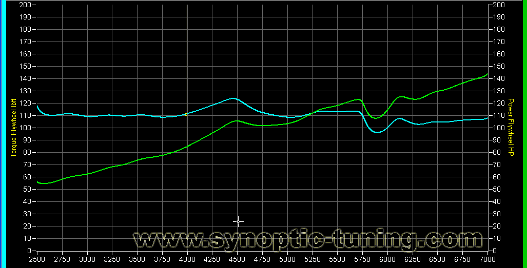

I suspect bad camshaft, or head problem. What do you guys think ? B16A2, 12.5:1 Comp. Eagle Rod and Crankshaft Skunk2 valvetrain 2.25 Exhaust, no CAT 2.5 Muffler 440cc injectors Vtec is at 5800 RPM. AF is 13:1 all the time. I tried those settings on the cam gears (crank degrees) : I +4 E 0 I -4 E 0 I -4 E -4 The power band would NOT SHIFT at all. Vtec lobe engagement problem ?

I would check to see if it is holding oil pressure to the vtec solenoid. Also would look for an air flow restriction. Have run into those problems before with similar results to your graph. Also check to see if the \"O\" ring is there under the third cam cap, I have seen a couple of do it yourselves overlook that and cause vtec engagement problems. Good luck

that's totally not right for those cams... Look for something mechanical

Ok, I got news for this engine. It seems that the issue here is the porting. Yeah, BAD porting. Seems like it was WAY over-ported and caused this. They took the ported ITR intake, ITR T B and put them on another B16 with 11.5:1 Comp with ITR cams, and the car ran like shit. When they put back the stock ITR intake and TB on the said B16, the car ran like a charm.
