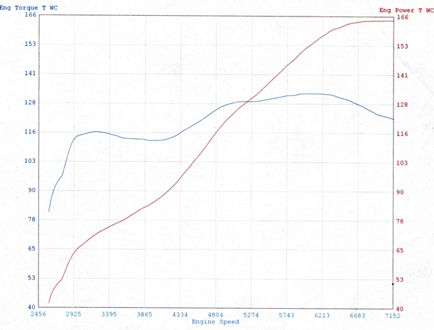

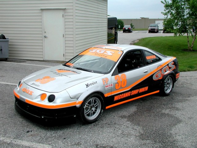

Engine: B18B (82mm bore, 10.1 Comp, Custom Cam) Spec: 4 to1 header, 2inch exhaust Everything else is stock, injector, fuel rail, ignition, intake manifold, throttle body, and intake system. No vtec head just a simple LS setup for all motor. This is a GGS Racing Integra that was dyno on are mustang dyno which most people know reads lower but add 20%. The car as of right now hold first place in it class, due to the rules of the build and what can be done restrick alot of power being made, but i was please for what I had to work with.

Those are sweet numbers for that engine on a Dynojet. :D

That power band is pretty nice!
Nice :D
