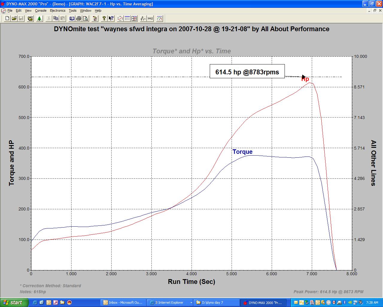

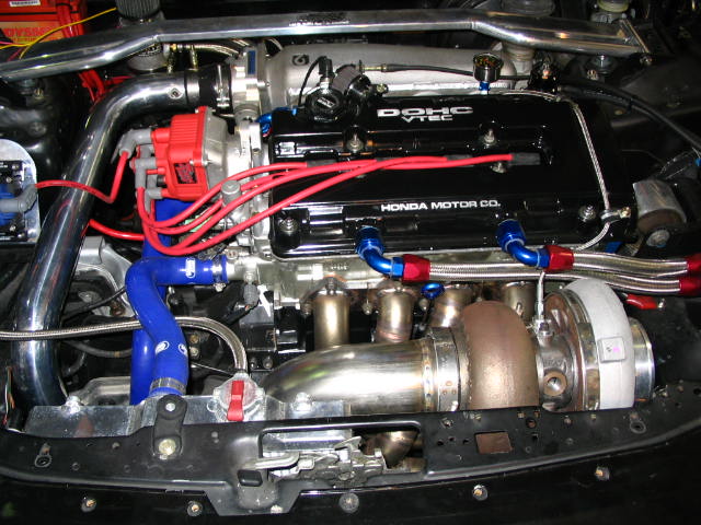

SPFWD Integra Wayne's / Randy's Turbo Full Race Pro AM kit. 42R Turbo Top mount Divided ex. Block 84mm GSR Block O-Ring Inline Pro Sleaved / Build 9.8:1 Pistons Eagle Rods Head GSR Custom Ported Head Type R Cams (Int. adv2deg Ex Ret.2deg) Springs, Retainers Ti. Full Race Intake Manifold 1600cc RC injectors, FJO Driver Box Aeromotive A1000 Fuel Pump Fuel Sump. MSD HVC 2 Coil NGK R5671a-8 Plugs (.10 Gap) VP NO2 Fuel AEM 5 bar Map eCtune controlling Boost with AEM Solinoid GSR Trans Stock Ratio. with Heat treated Gears and pinion. Quife Diff. Custom Engine wiring. all Heavy gauge wiring to Fuel and ignition. We are at 27psi. I will be adding more boost soon. we have an O-ring block so I'll see how much it can take. As long as the trans holds up. Last track run was 10.70sec 1.77 60' 133mph in the 1/4mile. This was on the previous tune 17psi 500hp. We will run the car at MIR this sunday I'll post up the new times.

I will update the Tune and Log in the tuner section.
shop pics 074.jpg (80.31 KiB) Viewed 11975 times
