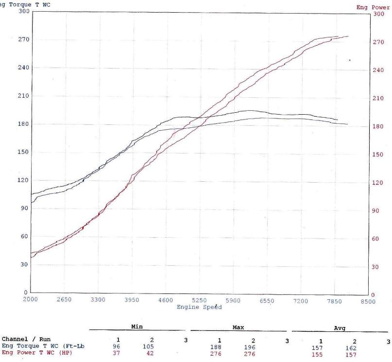

Stock GSR 6psi 276whp/196tq
Stock B18c1 Skunk2 IM Ebay turbo kit 57 trim t3/t40e MSD Fuel pump MSD Ignition setup DSM 450cc inj Simple setup, everyday driver for the kid. The car suppose to go to the track this weekend depend on the weather. It's in a EG hatch..

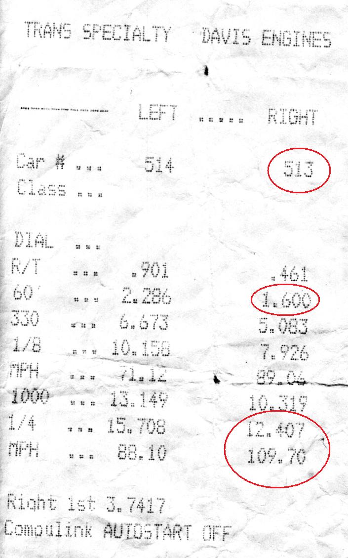

The kid went to the track yesterday and his best time was a 12.4.. His mph started to drop from 118mph to 108mph due to his clutch starting to slip. With only 4 passes before the clutch taking a shit on him. He had really good 60ft with 22in MT.
