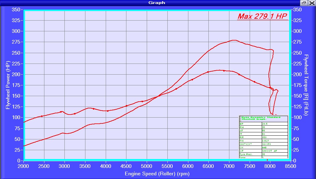

D16Y7 - Vitara Setup - 23.5 psi - 280 whp
Setup is as follows: Stock D16Y7 Head D15B7 Block, 200k miles plus...slight hone Vitaras and Eagle rods RX7 550cc Injectors Stock IM Small Intercooler Wacky charge piping Side exit exhaust GM 3 bar This car was FUN to tune :)
zex_cool
Posts: 212
Post by zex_cool »
d15 w/ eagles ? im sure its a typo. what size holset ?
No typo..it had Eagles Holset HC1, thats all I know. built in traction control with the slow spool
zex_cool
Posts: 212
Post by zex_cool »
it cant be a d15b7 then.. isnt that kind of a lot of boost for that much power ?
Heh. Eagle will custom-manufacture parts upon request... just like any other piston/rod manufacturer. And... Holy crap, ~280HP on a D15B7!!!

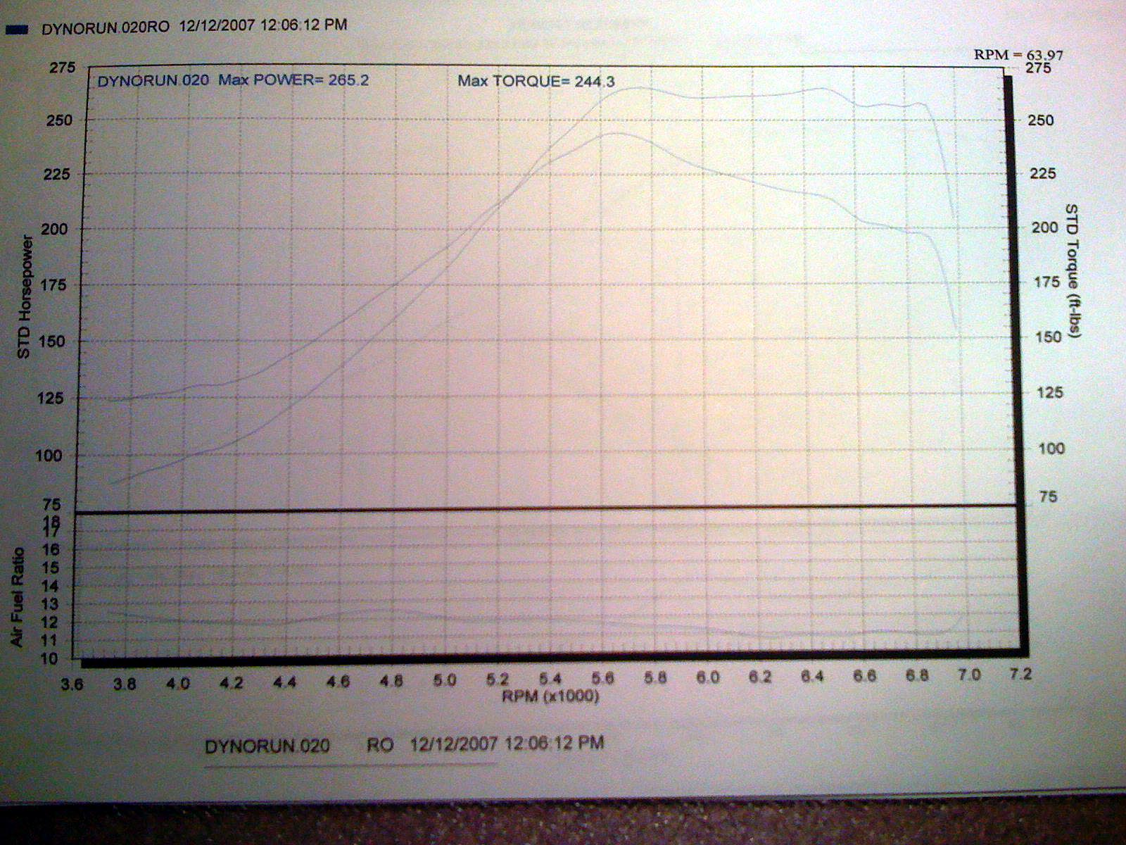

I just did a D16Y7 last week that made 265@ 20PSI on a SC61.. It had Eagle rods, SRP pistons, and everything else stock. I'll post the dyno later.. Be a cool comparison.
Def post it up :) This car/driver went 12.15 with this car and his old setup (just barely 200 whp) so I cant wait to see what he does with this :)

Heres the Y7 I did not too long ago..
Sorry it came out huge..

torque start to fall @ 7k on a Y7 ??? WTF ?
Thats where it hit peak boost :)
