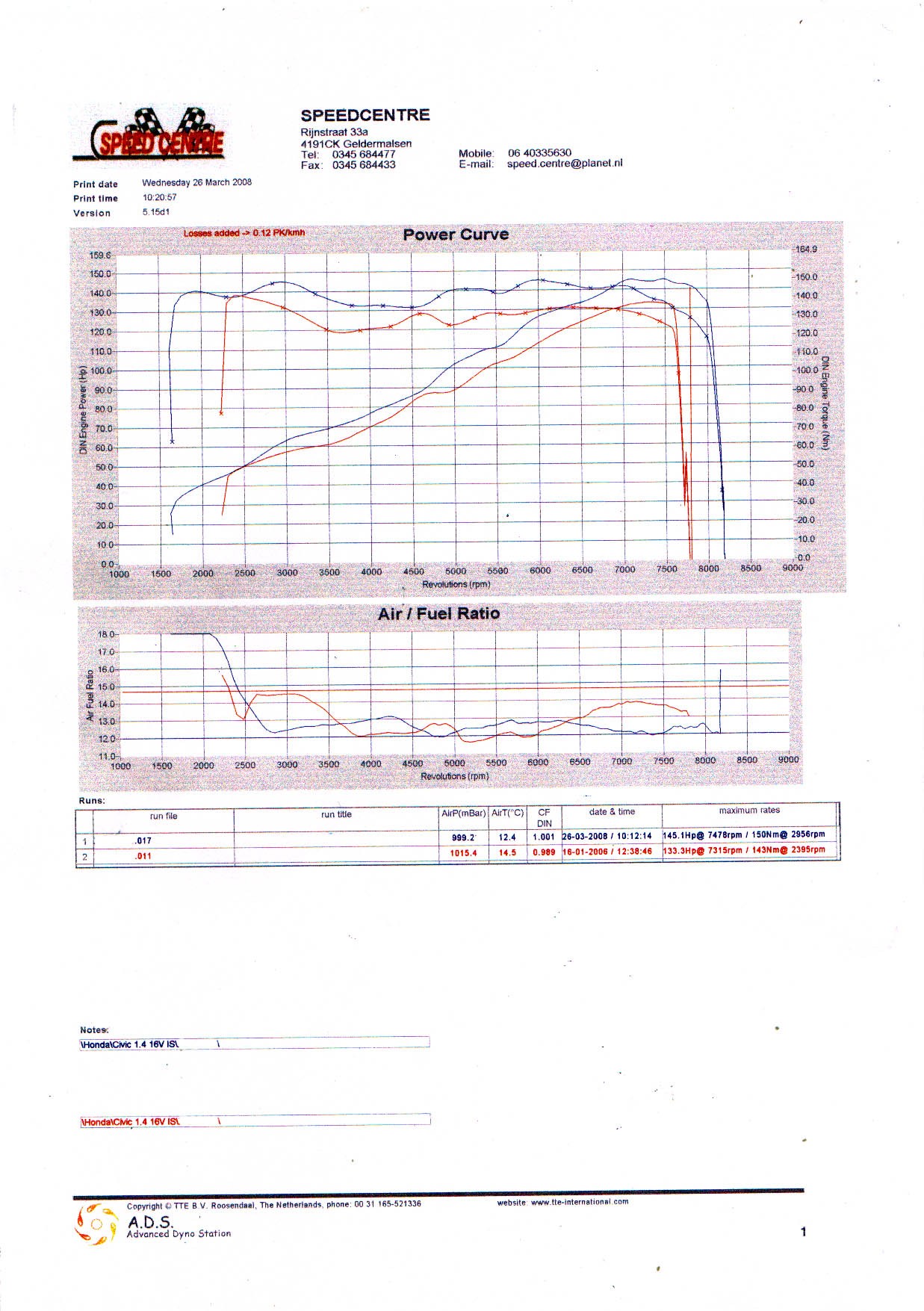

Small European 1.4 engine, stock 75hp. Stroke 79, bore 75. Main changes: Skunk2 TB/IM/cam/retainers/springs D16Y8 head 4-2-1 header and 55mm exhaust. OBD1 swapped and most important, eCtune chipped. The red line is Skunk2 stuff replaced by ESi stuff and Crome tuned I believe, 2 years ago...Small results: D14A3 145.1hp and 150Nm
