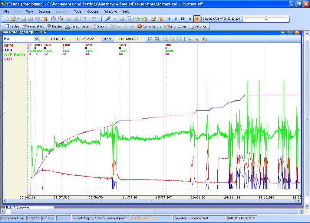

It was nice and cold last night so I logged my start up and ect correction works well below 60 deg. If its cold enough I'll do negative post fuel correction and see if I can take care of the little dip to 11.3 right after start up.
lowstart log
lowstart log
teg low start.JPG (138.61 KiB) Viewed 11842 times

I cant promise the weather will hold out I think it will get warmer soon. The soonest I can retune would be this weekend. If none of this matters then shure. Tonight I was going to mess with the post start fuel and see what happen
