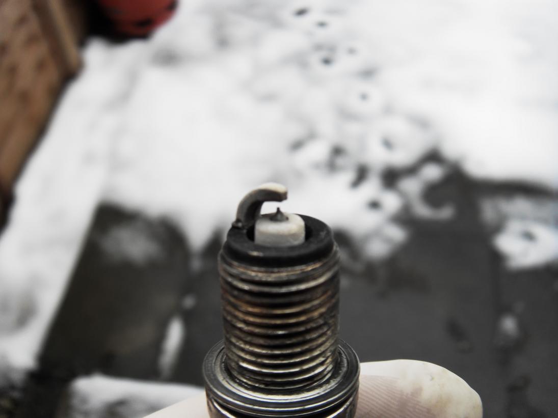

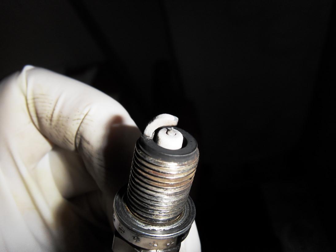

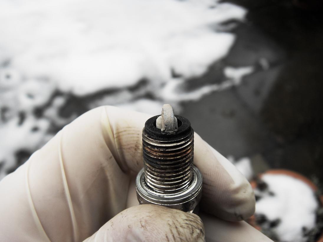

Hello everyone, one of my customer is a bit scared about the color of his spark plugs after a mapping (DC5 K20A) I would like to know what do you think about So let me know please :wink:

Looks like those have been in there for quite some time? I wouldnt say they look to bad. I would put a fresh set in and check them after a tank or two for a more accurate long term representation.
for the most part (aside from old) they look ok... the heat is a little closer to where the strap meets the plug body for my tastes, but other than tat they look ok... I would like to see a new set of plugs; and I'll post up a few pics of the plugs I pulled from my motor yesterday for comparison... they are similar, but not as old as yours..... minor differences
Which picture are you even seeing a clear view of the heat on the strap?
not clear, but close; top and bottom; looks like the heat is getting pretty close to the body of the plug.... from lighter up top to darker...

the fuel he's using is Shell V-Power 97 (UK rating). I went back to see the customer last night. We changed the plugs for some NGK BKR8EIX (so slightly colder). After 2h of driving a light film of white dust, which could be removed with the skin of the finger, had deposited on the strap. In the meantime we had altered the fuelling to show the customer that the white stuff wasn't because the car was running lean. thank you for answers.

The deposits are from that V-Power shit, I recommend my customers stay far far away from that gas.

Xenocron nailed it on the head, v-power deposits for sure, see it all the time. Unfortunately v-power is considered one of the better pump fuels in the UK lol
i fill at the VP station they put in the next town Gilroy =) when boosted, my car loved it and felt happier throttle wise... plugs came out cleaner after 5k miles too.
And here I thought V-power was supposed to clean the engine, rather than leave even more deposits than regular fuel :) Interesting... I´ll look out for those deposits from our otherwise nice 99 RON octane V-power here in Denmark. Supposedly this should be free from MTBE. /Allan
Vpower is RON 97 overhere. I never use it. It burnes way too fast for our high performance boosted engines. Its nice for economic cars with advance knock systems but on older cars its a no go!
