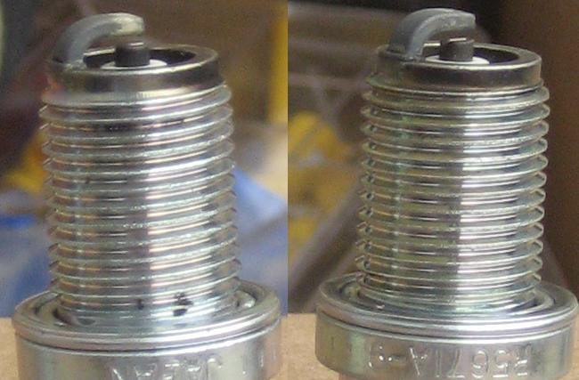

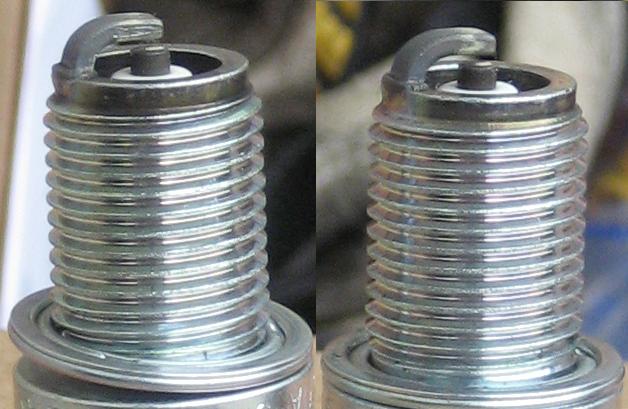

Here's the pics of the 9's. They aren't that great as it was overcast today and lighting was dim. It's a little more difficult to see the blue line on these, is there a trick to it that I don't know about?
no 3 and 4
no 3 and 4
plug no 3 and 4.JPG (43.84 KiB) Viewed 14704 times
no 1 and 2
no 1 and 2
plug no 1 and 2.JPG (46.23 KiB) Viewed 14704 times

Update: I ended up having an exhaust leak where the header meets the downpipe. I didn't catch it for a little while so I kept on changing the AFR's, and the leak kept growing. By the time I caught it, my AFR's were WAY rich. Took me a week to get the right gasket. Anyway, got that fixed and put a new set of R5671A-9's in. I have to say, changing to the R5671A-9's has made a HUGE difference. It's like a completely different motor. The responsiveness is just sick... I can't believe I put 5k miles on this motor with the wrong plugs. It cleared up a lot of other issues, like tip-in and tip-out tuning and fuel cut surging. Anyway, got the AFR's back where they belong now, and the tip in and out tuned as well. Hopefully if I can get some time off this weekend I can do some more WOT pulls and get back to tuning my timing.
