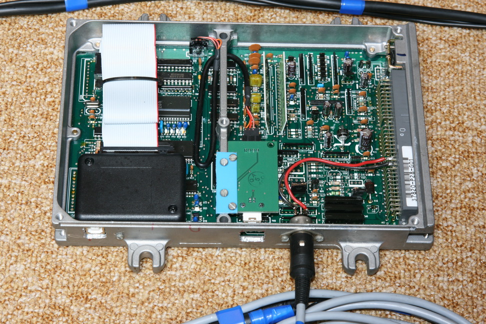

I will update this post with a photo tomorrow; but I managed to squeeze my Ostrich 1 and my old-style HULog into the ECU casing; with only 2 USB cables coming out the top of the cover on the backside... so when mounted in a stock location, the wires come up and out the back, not near the door; so all needed to be done is run the tailpipe probe or o2 in the downpipe, and hook up the power for the LC1 direct to the battery... No more huge clump of tuning equipment to clutter a passenger floor ;)

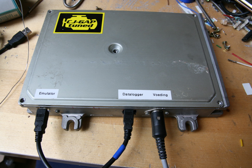

I made a new tuning ecu for the upcomming eCtune Belgium. Easyer than this is not possible! Just put the ecu in, plug the plugs in the laptop and ecu and its ready to go.

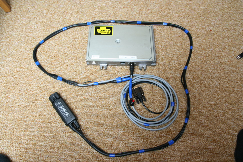

How is the WB signal fed to the ECU? \"Voeding\" is realy the 3A current for the wideband? I was thinking of doing it that way, but was not sure if the 'mains' were able to draw 3A of power for the WB. And I wan't sure if it would cause spikes in the ECU's main power supply. Although.... a very very nice installation Frank.
I had it always like this in my own car. The only difference is that in my own car I took the power from the wires outside the ecu, and in this case I took power from within the ecu. Never had any problems with blowing fuses. The wideband signal is not wired at all! Its just power, nothing more. Its a ecu only for tuning so the wideband can only be measured by the serial connection.

But still I don't see a WB feed to the ECU. How is that done?

Orthello wrote:But still I don't see a WB feed to the ECU. How is that done?
serial connection

Oh F*** yes. Serial connection is directly to laptop, not to the ECU. Sorry. :oops:
