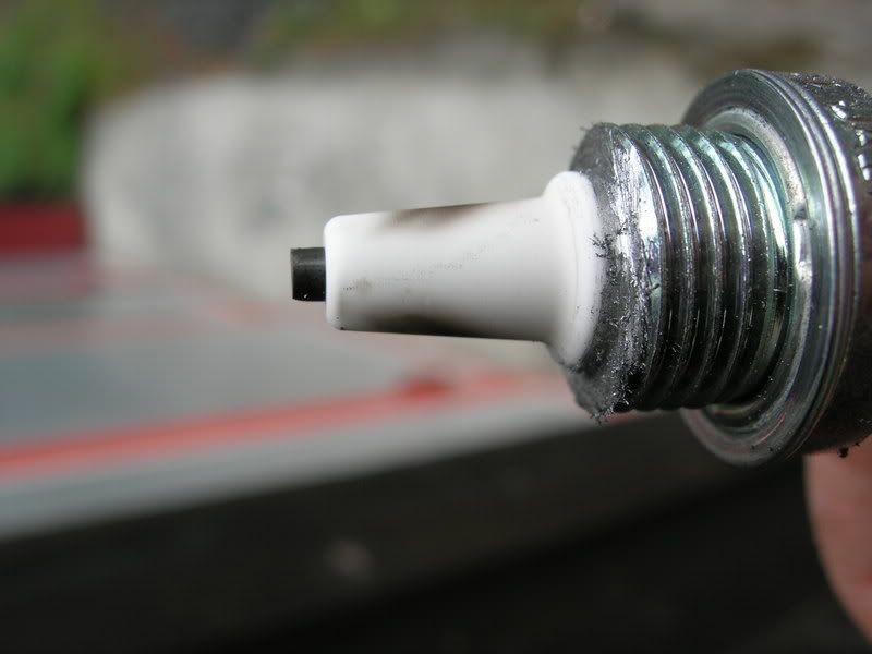

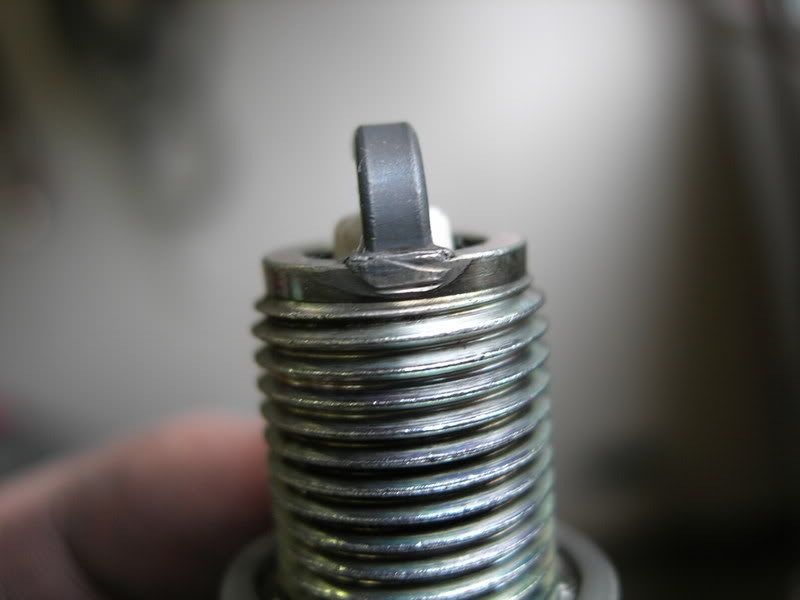

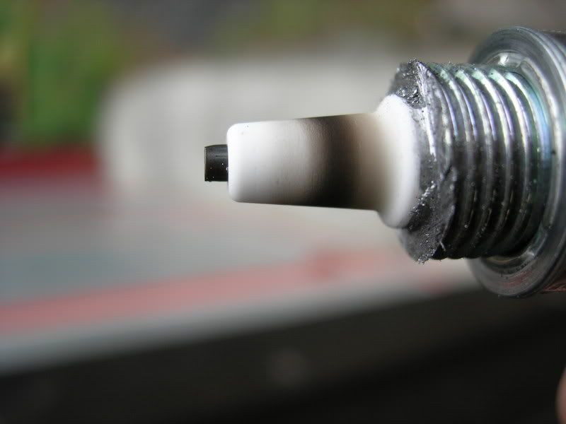

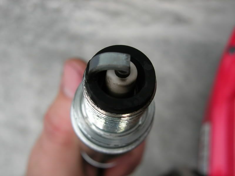

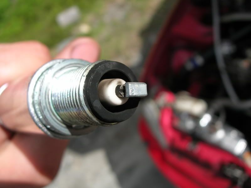

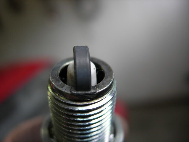

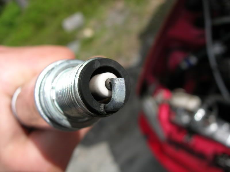

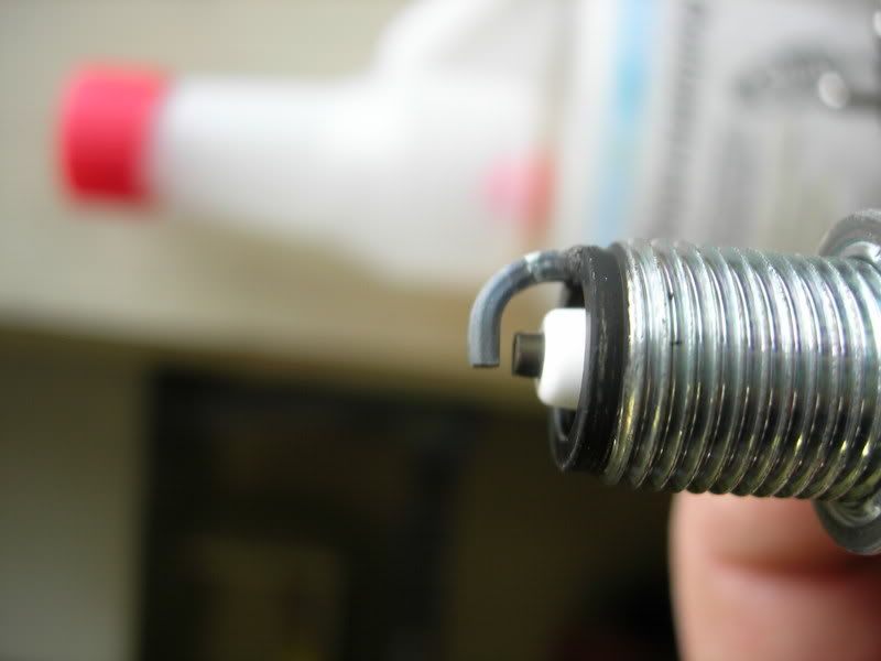

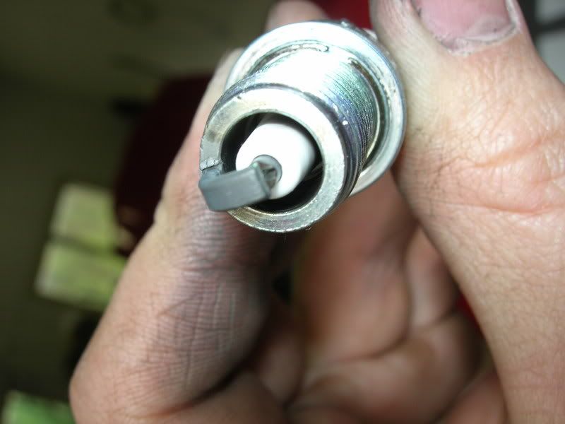

						So today I took out the plugs and cleaned them like Burgermass said. Here's the pictures, from #1 and #3:
    I really cant see any color on the treads, so I dont know if you get anything out of these...? Only color I still can see after cleaning them is where the ground strap is welded to the plug.     On picture 2 and 5 there's a black spot on the porcelain though. Is that how detonation looks like?      Sewell94:  Yes, I did the timing sync when I made the basemap, so I'm pretty sure its correct. The wet stuff on some of the pictures looks and smells more like fuel to me. In cyl#1 I'm not sure though. Something looks a bit fishy in there, with soot and some stuff on the ground strap. I havent noticed any oil consumption or smoke (except when I hit the rev limit with ignition cut) either, and I did a compression test last month with good results. SOmething might have happened last trackday, though, so I'll make sure to do a compression test.    So I'm a bit confused, whats the next step now?  Add fuel?  Pull timing?  Colder plugs (can I just buy one colder plug and see if I get the color I want, or do I have to buy all four)?  Or all three at once?     I also wonder what will happen if I use too cold plugs? I understand that running with too hot plugs can cause detonation or possibly pre-ignition, but what about too cold plugs? Blowout? And can it hurt the engine running with too cold plugs?
    I really cant see any color on the treads, so I dont know if you get anything out of these...? Only color I still can see after cleaning them is where the ground strap is welded to the plug.     On picture 2 and 5 there's a black spot on the porcelain though. Is that how detonation looks like?      Sewell94:  Yes, I did the timing sync when I made the basemap, so I'm pretty sure its correct. The wet stuff on some of the pictures looks and smells more like fuel to me. In cyl#1 I'm not sure though. Something looks a bit fishy in there, with soot and some stuff on the ground strap. I havent noticed any oil consumption or smoke (except when I hit the rev limit with ignition cut) either, and I did a compression test last month with good results. SOmething might have happened last trackday, though, so I'll make sure to do a compression test.    So I'm a bit confused, whats the next step now?  Add fuel?  Pull timing?  Colder plugs (can I just buy one colder plug and see if I get the color I want, or do I have to buy all four)?  Or all three at once?     I also wonder what will happen if I use too cold plugs? I understand that running with too hot plugs can cause detonation or possibly pre-ignition, but what about too cold plugs? Blowout? And can it hurt the engine running with too cold plugs?-

Those plugs don't look like they are getting hot at all to me, but its hard to tell from pics. That spec on the insulator looks kinda fishy, I can't tell if its metallic from the images though. but even though theres no sign of heat in the plug they do look very lean to me..    I wish I could help more but its so hard to tell from the pics..

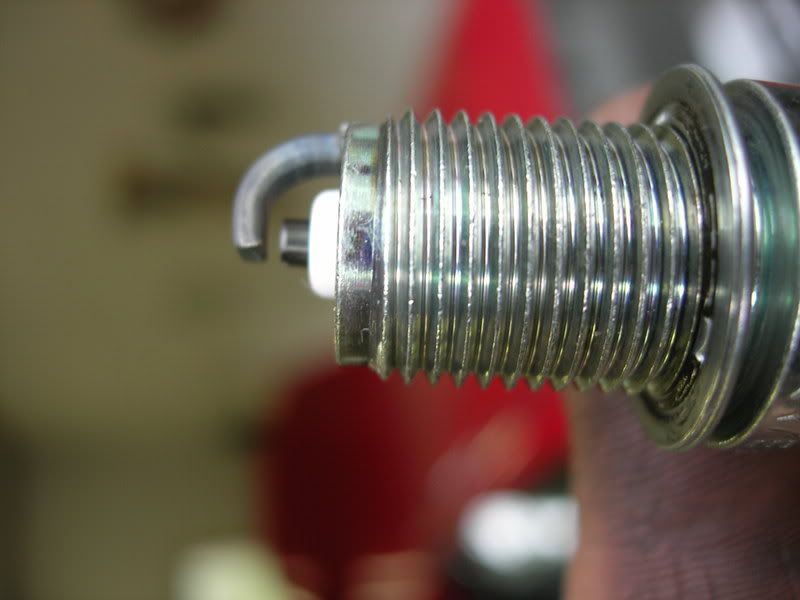

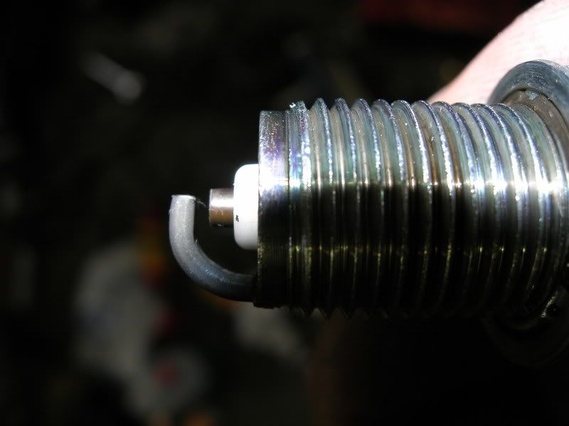

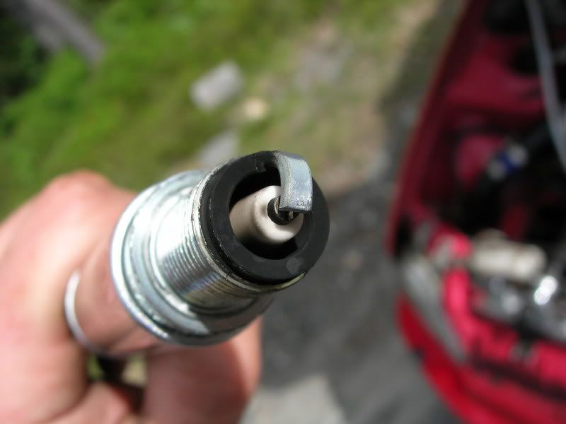

						So today I got a little time to play with my car again
    I added a bunch of fuel, and thought I pulled some degrees timing, but my computer decided to crash, and I probably didnt save the changes, cause now that I am home I see that my ignitin map is still the same :p I actually noticed that a crispy sound I had earlier in my detcans now was gone. Dont know if it was slight detonation before, but its gone now, so I guess its good. I changed plug #3 so I could get some decent readings, and did a few pulls, then stopped @7000rpm. My wideband now reads between 9 and 10 AFR (difficult to get it stable, cause I couldnt get ectune to read that low atm, so I just kept an eye on logworks). Here's todays pics of cyl #3:
      I finally got some color to the porcelain, but mostly on one side, though. Dont know if that just means it'll take some more pulls to get it even all around? And the blue line on the ground strap was really easy to see now (if I'm looking at the right thing), how does that look to you? One thing that I noticed was that around 4500-5000 rpm I got a real powerboost, the turbo spools @ 3000 rpm, but once I reached 4500-5000 it felt much stronger. That was weird. And I'll have to go to a real road to get a feel on how it really pulls, anf maybe play a little with vtec point.    It seems like my WB is totally off, though, so I guess its time to buy a new sensor (I have tried calibrated it several times). Havent heard of any turbo honda that needs to run 9'ish afr before...?
      I finally got some color to the porcelain, but mostly on one side, though. Dont know if that just means it'll take some more pulls to get it even all around? And the blue line on the ground strap was really easy to see now (if I'm looking at the right thing), how does that look to you? One thing that I noticed was that around 4500-5000 rpm I got a real powerboost, the turbo spools @ 3000 rpm, but once I reached 4500-5000 it felt much stronger. That was weird. And I'll have to go to a real road to get a feel on how it really pulls, anf maybe play a little with vtec point.    It seems like my WB is totally off, though, so I guess its time to buy a new sensor (I have tried calibrated it several times). Havent heard of any turbo honda that needs to run 9'ish afr before...?I tried to take a few pictures thats easier to read for you guys today. Found a thread in a forum where they hacked up their plugs after a run to see the color on the porcelain, so I did it on one of my old plugs that looked really lean for me and got pretty surprised when I found a nice coat of black soot. So I tuned my AFR to 10.5 in boost, and pulled out another 3 degrees. My car was actually bogging at low rpm at that point, and pulling like crap, so I just put the timing back in there. Im pulling 1.2 degrees per psi now, leaving me at 14.5 degrees at 11psi and redline.     Heres the plug before cleaning:

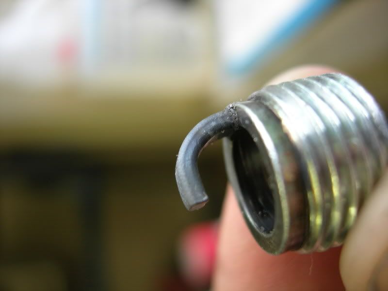

    And after cleaning (and hacking):
    It looks to me like the blue line at the ground strap is right in the middle of the curve. Thats pretty conservative and should be safe, right?    Here's the rest of the plug:
    There's apparently more color to the porcelain than what I thought before, so I guess I just suck at taking pictures. I guess it has probably been more or less like this all the time. These pictures was taken after 3 3rd gear pulls in a row, wot and some braking, to get maximum load on the engine.     Now it leaves me with a few questions for you:  Why is the fuel ring not connected all around?  Why is it sitting there, and not on the bottom of the porcelain, like in the pictures in every \"how to read spark plugs\" on the web?  There's no sign of black \"pepper\" on the porcelain, so it doesnt look too bad, does it?

On the very first pics, I could see aluminiums specs on the procelaine and some white spots ont the rim. At that point, I think you were a little bit too lean . This lean condition (hotter burn), mixed with the current timing map you had, could have lead to some preignition (alu  specs). Adding more fuel could have lowered the temperature enough to keep the same timing map maybe, no one can tell.    I think your are running too rich right now looking at the last picture. No pre-ignition though, which is good. The black coloring is not all around the procelaine because it's the way the flame contours the procelaine and leaves it's black trace only on the side it directly touch. This tells you how the plug is placed relatively to the exhaust valves.    Black rim and white tip is normal for turbo car running a bit on the rich side. The carbon will stick to the rim because the rim is colder than the tip. The tips will be a little whitish because of the carbon that deposit on it (because it's runnign rich enough to cool the plug and sick a little bit on it's tip) and get's burned at very high temperature.    When pple say white plug = too lean, they are not always right. A lean condition shown by a white plug is valid only when the plug is USED and was COLORED BEFORE. The carbon on it will turn white be cause of the heat generated by a lean combution. NEW plugs will never turn white as the carbon will not deposit before getting burned because there's not enough fuel. The spark plug however will show signs of over-heating and maybe sign of preignition/detonation.    running lean, in itself is not a bad thing, it's the heat created by the lean burn that is bad. If you can  remove the heat, you can run leaner and make more power. Running rich serves only to cooldown the combustion.    If your wideband is right, ake some pulls around 11.5 - 11.8:1 wthout touching the timing and check the plugs back. Post pics and then we'll see.
