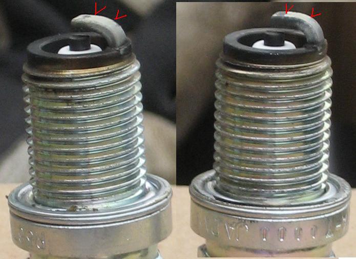

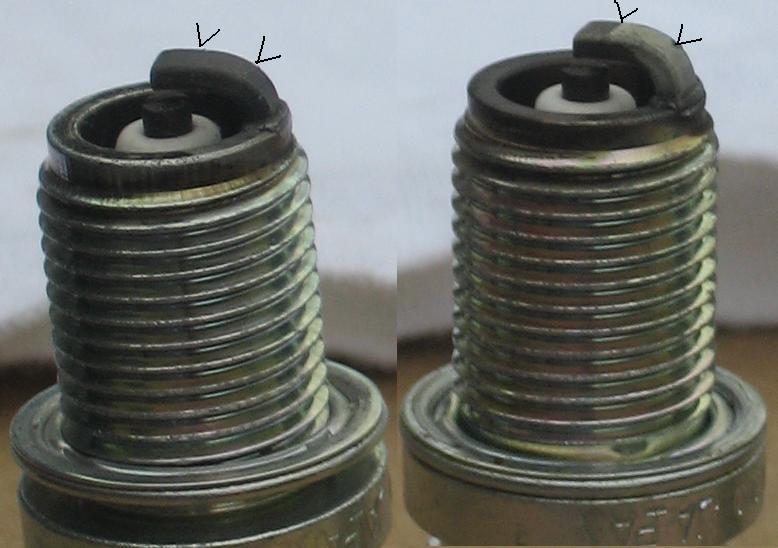

Logged with new plugs in today to and from work, approx. 35 miles each way. Richened AFR's up to about 12.5 at WOT. After getting home, went out and while the car was still hot and ran 3 WOT pulls. Ran through the first 3 gears in all 3. The last time, shut the car off at about 7100 RPM and pulled the plugs. Here are the pics. 1. A little more color on the threads 2. Still no fuel ring. 3. 2 marks seem to be showing on the ground strap now. (marked with arrows in the pics) 4. Higher RPM's (from about 4k up) weren't nearly as strong as before. Seemed like it took forever to pull all the way through 2nd gear, and 3rd gear seemed a bit sluggish too. Not sure if it's the added fuel, or the hotter plugs. Let me know what you guys think.
Cleaned no 1 with brake cleaner, no 2 uncleaned.

no 3 and 4 uncleaned
plug no 3 and 4.JPG (54.95 KiB) Viewed 13696 times
the first mark on the top of the ground strap is the initial spark. The second mark is the actual color change from the heat exchange. The straps look good from my point of view so keep your timing where its at until you can hit a dyno. again, the fuel ring you are looking for is hard to see without a trained eye, a good magnifying glass and in good lighting. The only other way to see the ring is the cut the threads off the plug to expose the porcelain.

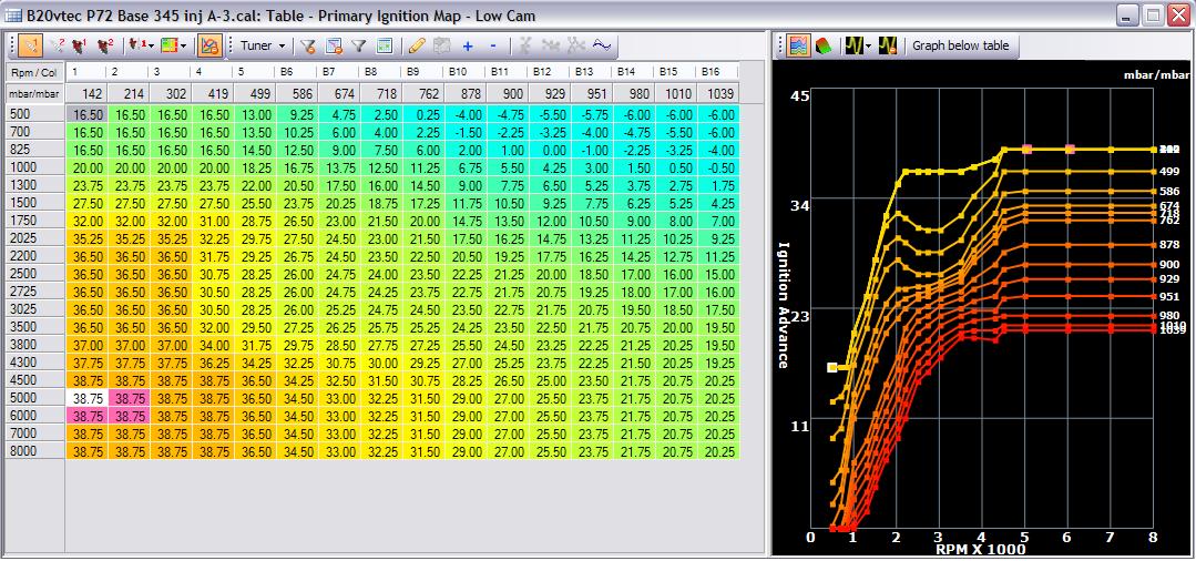

Any idea why the power loss with the new plugs? Here's a little info on them in specific: NGK R5671A-7 stock no. 4091 Gap: .032 Also, remember that this is just the low cam that I'm running right now, vtec is disabled til I can get the low cam perfect. You sure I don't need more timing?
current low cam table
low cam ignition.JPG (163.96 KiB) Viewed 13686 times
you are running too cold of a plug man. my 12.2:1 comp h23vtec didnt want those 4091's. i stuck with the zfr7. if that second set of arrows is indicating where the beginning of the color change is, then that is where the timing needs to be. do you have the honda ignition advance turned off?

Honda ignition advance turned off? I'm not familiar with that. The only thing I've seen that even slightly resembles that is Ignition Corrections? Disable ignition correction above 1031mbar? I don't have that checked if that's what you're talking about. The second arrow is where I can very first see a slight color change, and I do mean very slight. Also to be noted is that the color change there is really only noticeable on the sides of the ground strap, and doesn't have a \"defined\" line. It's more of a gradient than a line. The first arrow is a very defined line, as you can see.
the ignition advance check box will either enable or disable the ignition correction in the background which is a ghost you cannot control. You can either turn it on, turn it off, or limit it to a certain pressure. When you turn the ignition advance off, it gives you more control over the ignition timing. The logged actual IGN will be closer to the MAP IGN with the advance turned off. So in your maps, especially in WOT, you are running a good bit more timing that what you are seeing in the map in the high load areas.
with the amount of compression you are running, you should disable it above 550mbar or so. The high load, low RPM areas are very very sensitive to timing and will detonate very very easily. However, with this ignition turned off, you open yourself up to have a bigger window for error and you can experiment with the timing a little more. Turn it off and play with the timing some more until you get the ground strap the way it is now. Then advance the timing until you start to see ANY sign of black shiny specs on the porcelain or until the porcelain looks \"glazed\". This will give you an idea of how far you can go with the timing and you can see on the plug what that looks like. Then retard the timing and watch the ground strap. Takes a lot of time, but its a learning experience. NOTE: ADVANCE THE TIMING SLOWLY and leave the low rpm, high load timing LOW. once you have an eye for this, you can change each cylinders ignition trim and thats another learning experience by itself and really needs to be done on a dyno to understand the whole process.
