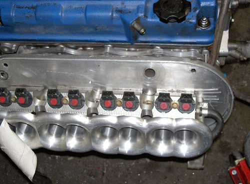

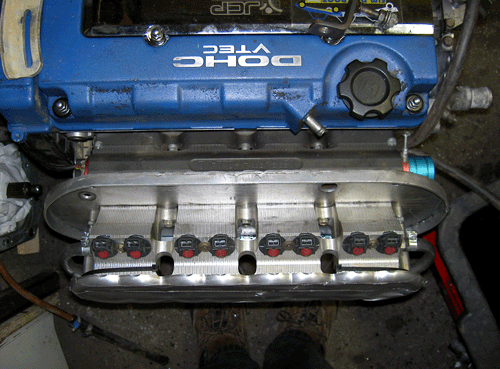

cyanide wrote:Where do you plan on putting the injectors? And how big are those throttle bodies? Will they rotate using lubrication between the inside and outside "sections"?

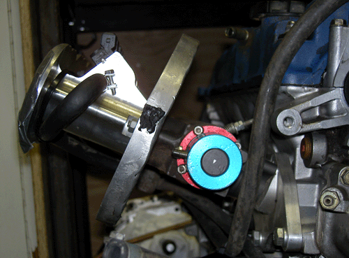

Injectors will be aprox halfway on the runners, like so; Image Throttle plate is aprox 42mm in size though because there are no throttle plates flow will be equal if not more as about 45mm which should be plenty for a n/a d-series. Lubrication isnt needed since the centerpiece is suspended in between the endcaps like shown here; Image
Have you ever seen these barrel ITB's? If you want a set, you can stay in Holland and go to Eimert de Groot ;)
