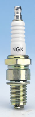

The 7173 have a projected insulator. Where the 4554 has a non-projected insulator. We've used the 7173 up until today.
Non-projected
Non-projected
Projected
Projected
ahh IC, that makes sence too.. Less low level detonation from insulator heat.

Well, for bigger power B-series I'm sold on the non-projected NGK race plugs. We picked up power on a different setup last night just from changing the plugs, despite a few degrees warmer ambient temps and the engine being heatsoaked. I'm a believer. Now, whether this holds true for NA, low power turbo, bigger bores, smaller bores, other engines, other ignition setups, etc, I take no official position.

I'm talking about the same temp plugs, just going from extended electrode (7173) to the non-extended electrode (4554).
hmm, interesting.. Mabey the effect I'm getting with the colder plugs isn't from the heat range at all mabey its from the fact that the insulator is shorter.. I\"ll have to do some reasearch on that.. Interesting stuff. . .
