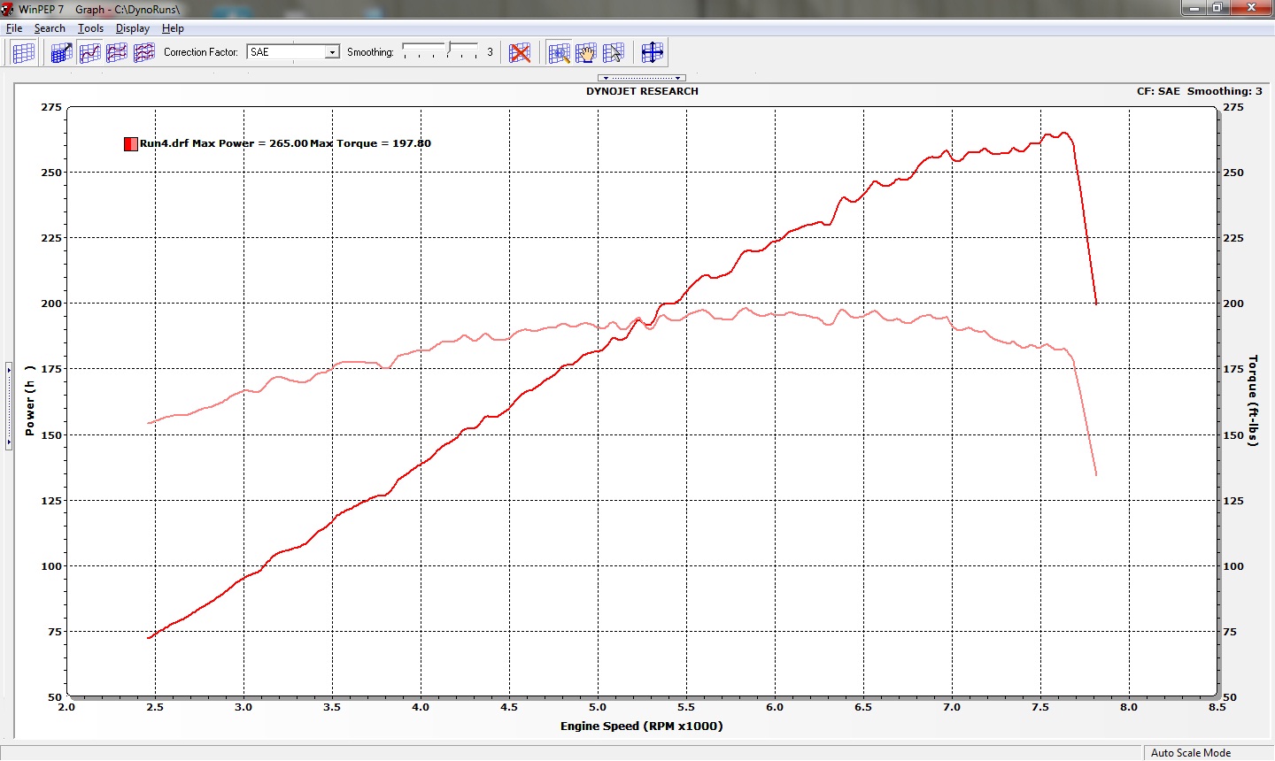

We're a lot happier with the knock sensor off, but I still don't like the noise in the curves, and we were expecting to hit around 280 and hoping for closer to 300hp with our setup. Since the noisy curves make us suspect ignition problems, we're going to replace the coil and igniter in the aftermarket (Distributor King) distributor with OEM units. We'll replace the aftermarket plug wires with OEM and replace the plugs too. Our AFR is at 11.8 and our spark advance is at 24.5*. We added a degree more advance and didn't see any more power so we dropped it back to 24.5*. I'm afraid to go any leaner than 11.8 for fear of detonation, so I'm hoping a better ignition setup will give us a little more. Also, our intake cam is advanced 3* and the exhaust cam is retarded 1*. How much impact could changing cam timing have , and what cam timing should we try next? Thanks in advance.
88 CRX HF, Darton sleeved, forged 2L B18C1 w/ P&P B16A head, CTR/GSR cams, LHT 3\" headers, ported JRSC M62 w/LHT Intercooler, etc. My son's car.
Do you see any indication of knock on the plugs? 24* is pretty much timing for a charger at 13psi. Try to lower the ignition a few degrees and see if the graph looks better.

We looked at the plugs, even under a magnifying glass and saw no evidence of detonation. We ordered and received a Honda igniter and coil and dropped it into the distributor. It seems it cleaned up the dyno noise a bit, but it is still there. I dropped the spark back to 18* and richened the AFR to about 11.5, and worked my way back up again. This time we didn't see power increase after about 21.5*, so I dropped it back to 20.25* for a bit of safety. At that point, my son wondered out loud if out stock intake (required for the CARB sticker here in CA) was causing us trouble, so we unhooked the air pipe frome the air box and ran it again. The results jumped up to 165/198. I think we are figuring it out... :) He's got a 60mm JDM B16A TB, with a B81A1 air pipe going into a CRX air box. The LHT modified TB port was opened up to 68mm I think, so it looks like we need to find an aftermarket TB and a CAI setup that will work in the CRX. Any suggestions for a new TB and CAI? Here's the final results for the day on the dyno:

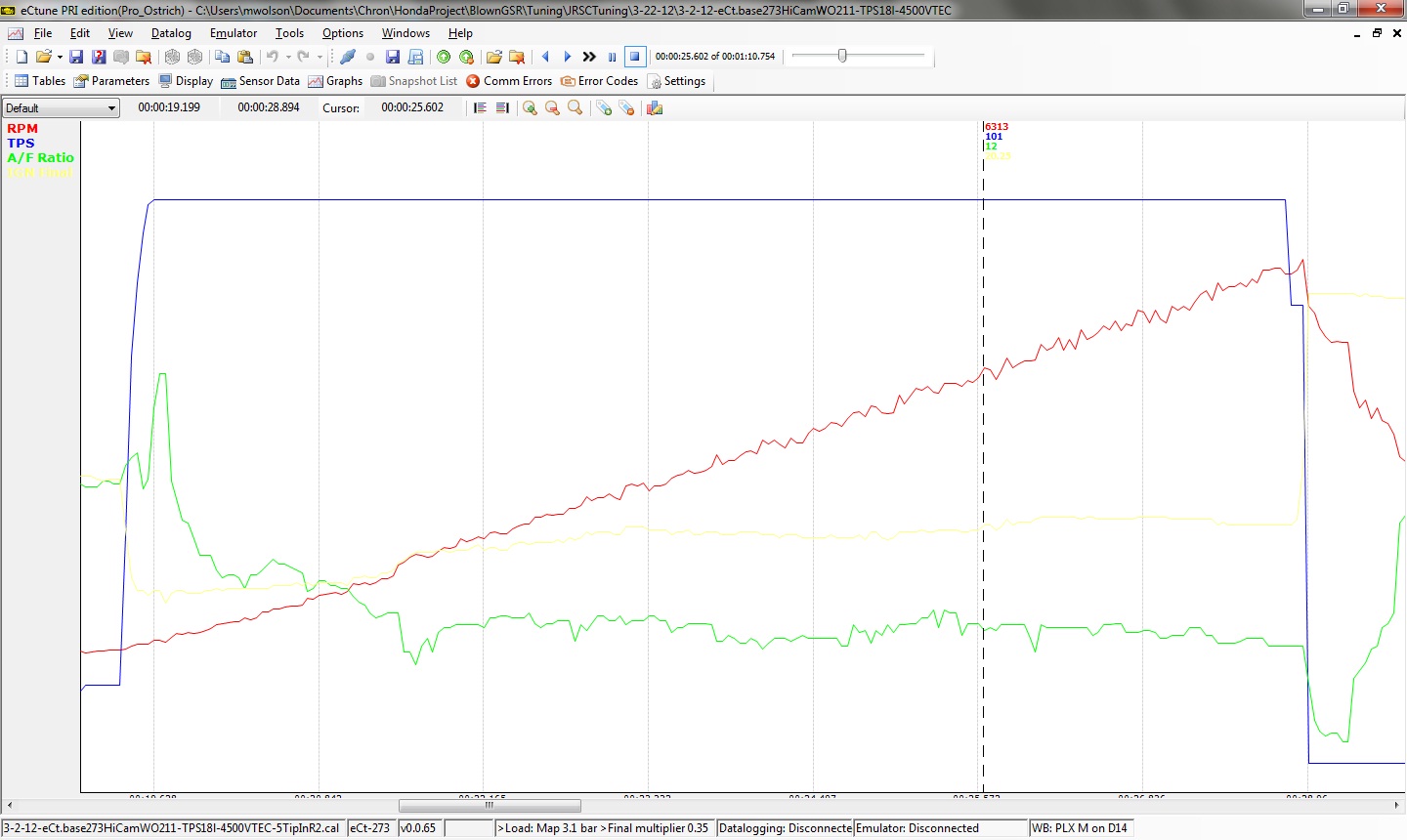

I was just studying my datalog for that last run on the blown car, and the eCtune log of the RPM is showing the same noise that the dyno curves are showing. It is interesting to note that the jitter in the RPM log is as much as 300 RPM over a 30mS period. What causes so much noise on the RPM plot? Is this a typical looking RPM log? I would have expected a much smoother graph...
Hi I 've just tune a car this morning and the rpm curve seems like yours I've never noticed that it was so wavy when you zoom on it or use only one graph in the screen

Thanks for the input. I went digging through eCtune forum archives looking for other RPM graphs, and I found a few. They all have the noisy RPM plots, so that seems normal. I wonder why the RPM logs are so noisy. Does the PCM think the RPMs are actually that jittery? Or is that an artifact of Calvin's datalogging code? It still leaves me wondering why our HP and torque curves are so noisy... These kinds of questions drive me nuts till I figure them out. :)
