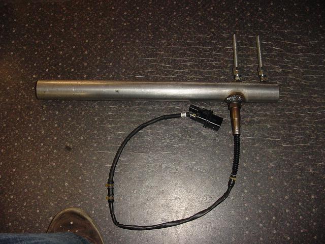

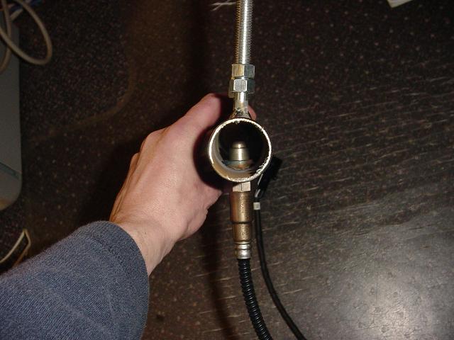

gaskleppie, how far from the end of the tube have you placed your sensor, and how long is the tube itself? I am actually going to recreate this unit because I like it's designs over a regular exhaust clamp because it does not leave a pinch mark on the customer's tailpipe.... I just got my LC-1 in the mail for doing CROME tunes; but I will also be using it on my car alot of the time as well... I have a feeling I will get pulled over asking what the hell is sticking out of my tailpipe =)
Its 45cm in total and the sensor sits at 10cm from the end of the pipe. Thats about 18\" in total length and the sensor is about 4\" from the end.
eh, my sensor is about 3\" from the end; if I need more pipe, Ill add it =P Here's a pic of the beginning of it: only thing left is clamp-down plates; I will be making 2, one for small pipe, one for big pipe. I like your idea of putting a DB9 on the end of a serial cable for the unit; makes alot of sense. I will be running that to a DB9 mounted on the ECU case and internally it will provede the ground direct to the ECU via the white wire, and a second cable with the power clips as you have them. Only difference will be a perminantly mounted USB->DB9 on the serial cable (which will probably want an extension to be long enough and not have too long of a USB cable).
