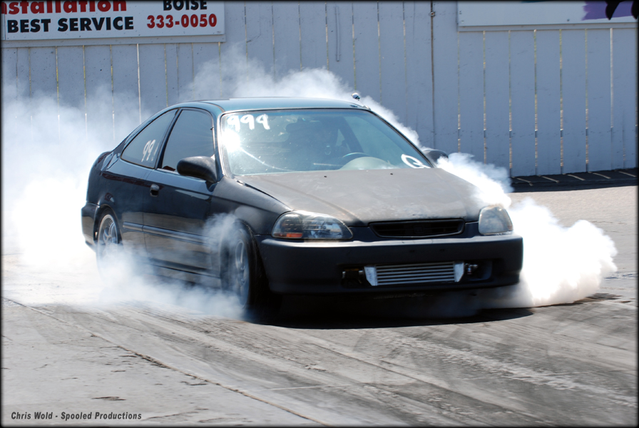

i run bfg dr's at the track. new gas and/or plug wires seemed to fix w/e the problem was. i havent had it brake up at all. here is a pic jst because. 8)
