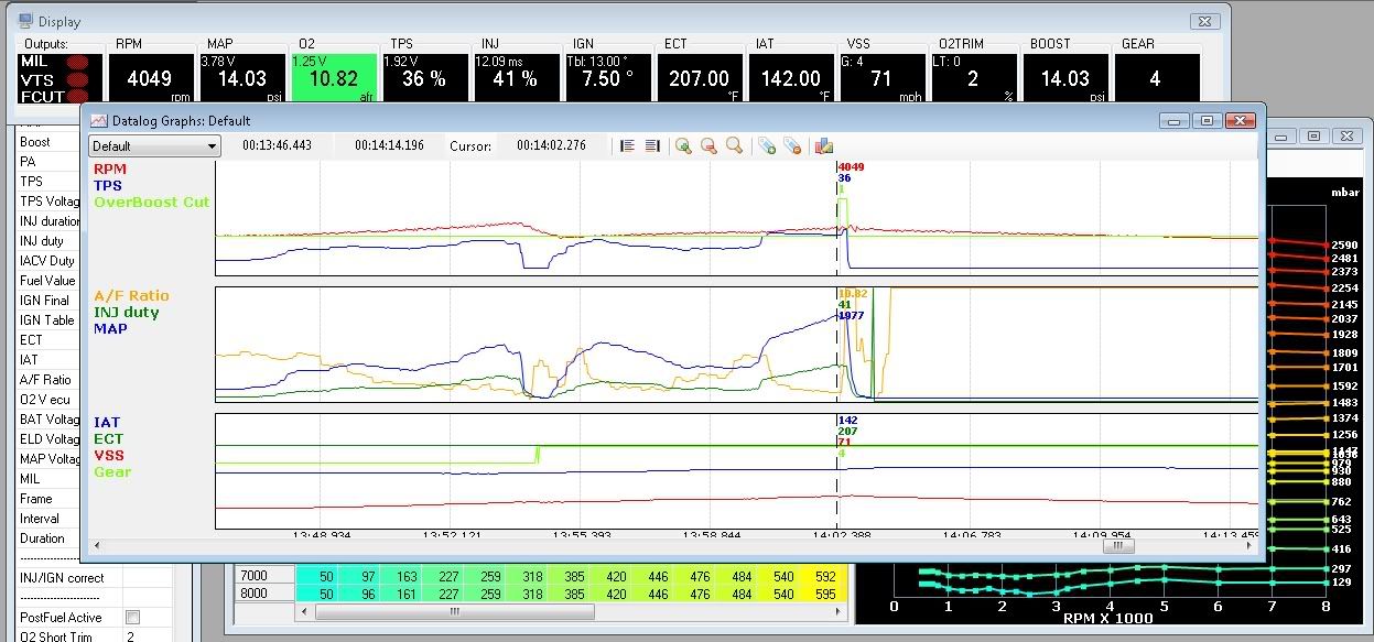

Ok, This is waaaay worse than without the SC, but maybe some of the tuners out there have seen the \"Evil Eye\"
    I am a little perplexed and want to blame my battery offset tables... any opinions?    It clearly needs it leaner than hell in that zone, and wants it richer than hell in boost up there....
    I am a little perplexed and want to blame my battery offset tables... any opinions?    It clearly needs it leaner than hell in that zone, and wants it richer than hell in boost up there....95 Sol Si : D16z6 : TD04H-13C   74 Civic 1200 : 100% Stock
