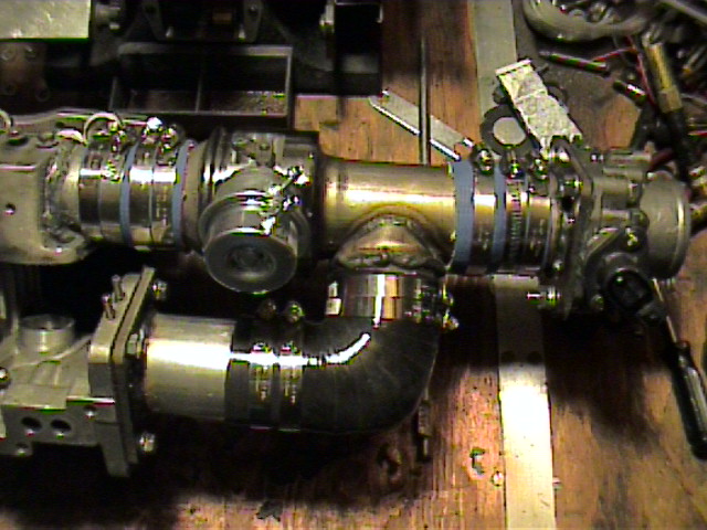

I just had a thought: What if I took the vacuum operated valve off, and added a wastegate lets say from an internally gated turbo. Attached is a pic of how it should be done... and I am trying to avoid this as an end result: Basically; run the internal flapper valve with a wastegate; and tie that into the turbo's WG. now; through a boost controller, and presto... I could route the flapper WG from seeing the boost controller to go SC than turbo... basically effectively change the way it works.... but the problem is I would need to reverse the mounting position for the WG flapper to make it work right... if I am thinking correctly. To disable the charger I could use the PCS to switch it off and bleed it's boost to reopen the valve.

it's RMC Daniel setup! it should work and be efficient
David974 wrote:it's RMC Daniel setup! it should work and be efficient
is directed towards a vacuum canister with 2 vacuum inlets, and one outlet controlled by PCS? I don't want to mod the charger like in the pic because it would immideately fail smog here in cali ;) Eventually, I want to work a way to be able to slowly turn up the boost on a edelbrock kit untill it is near max flow (starting to drop off in effitency); Then start enabling the charger slowly as a second boost controller after the first has reached it's target. I know I have alot of ideas... but it's one step at a time; I have many ideas about the deal, but I will see if I can get a diagram of the latest idea with a vac. cannister to show you guys what I want to try... visually.

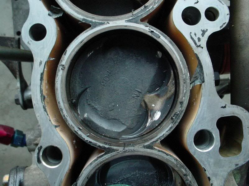

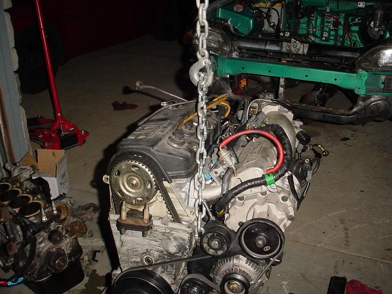

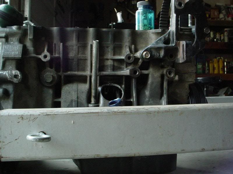

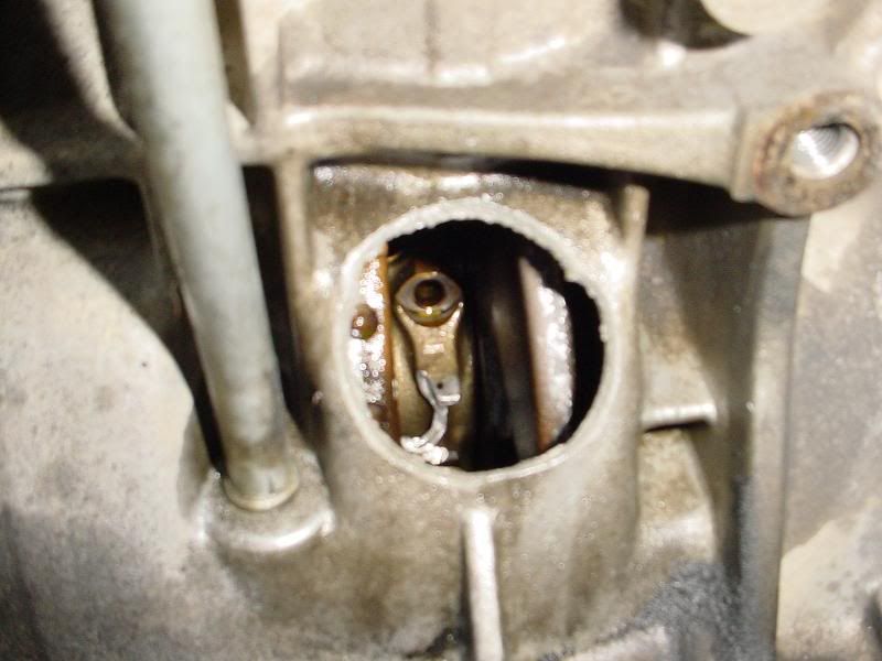

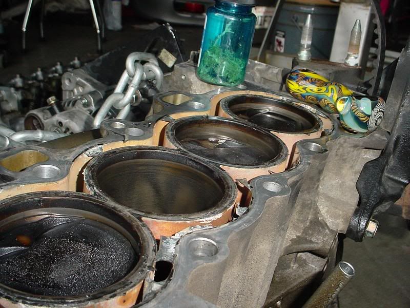

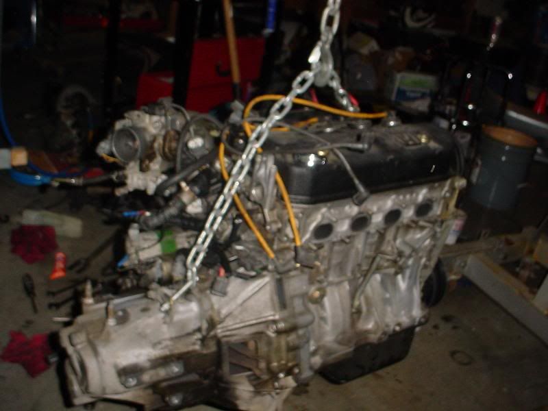

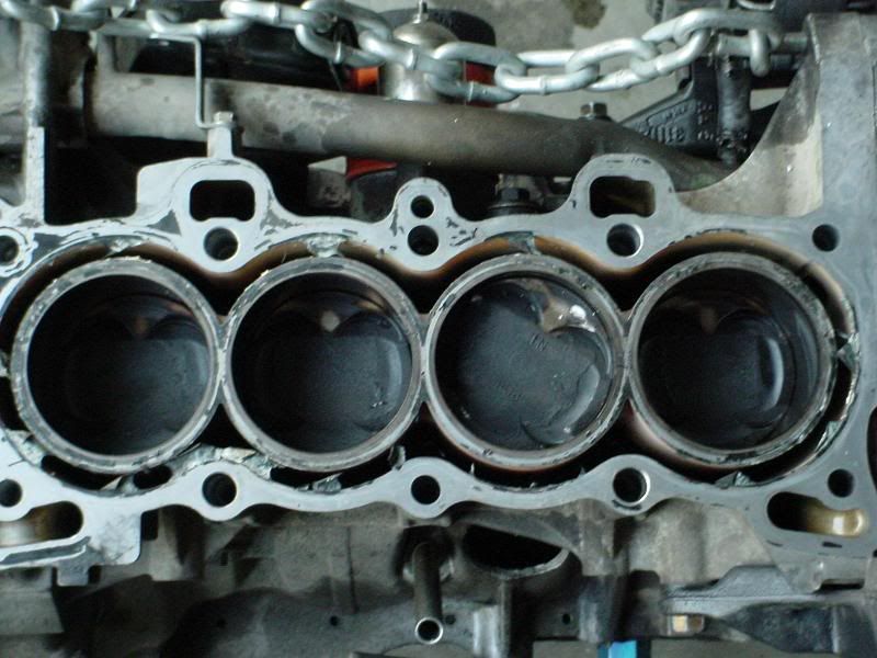

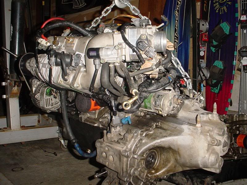

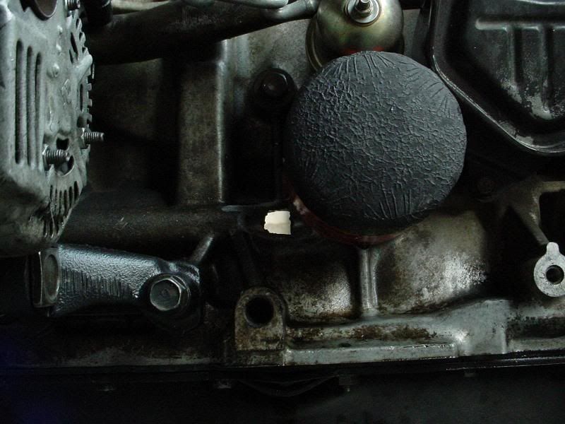

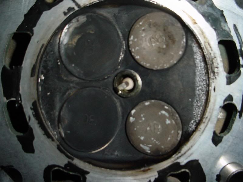

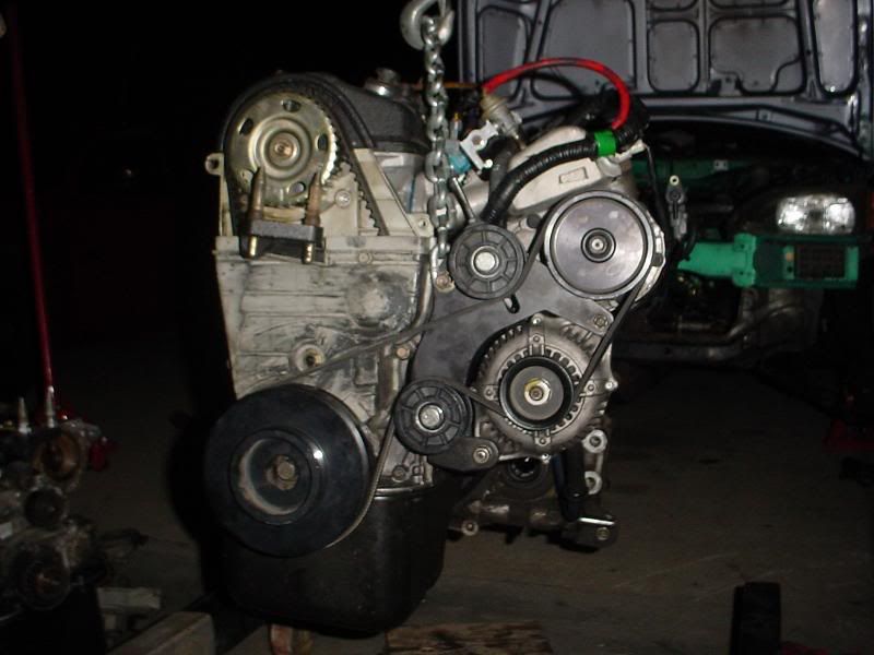

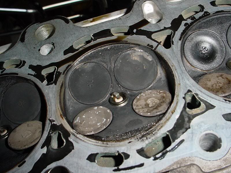

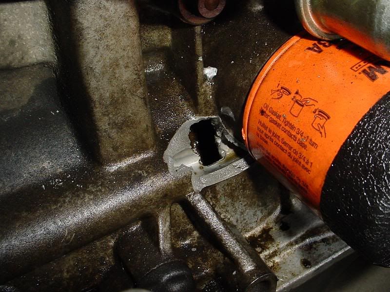

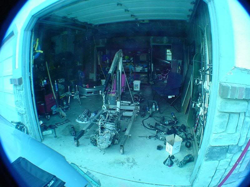

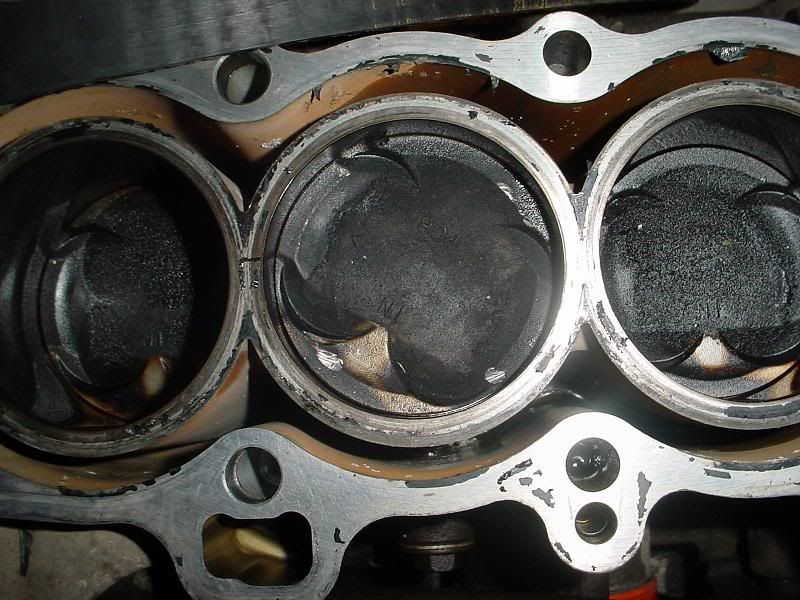

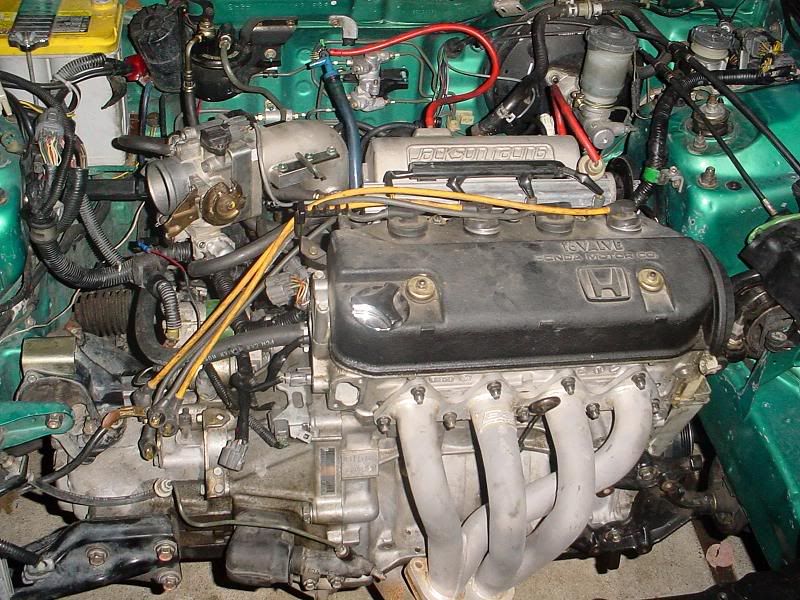

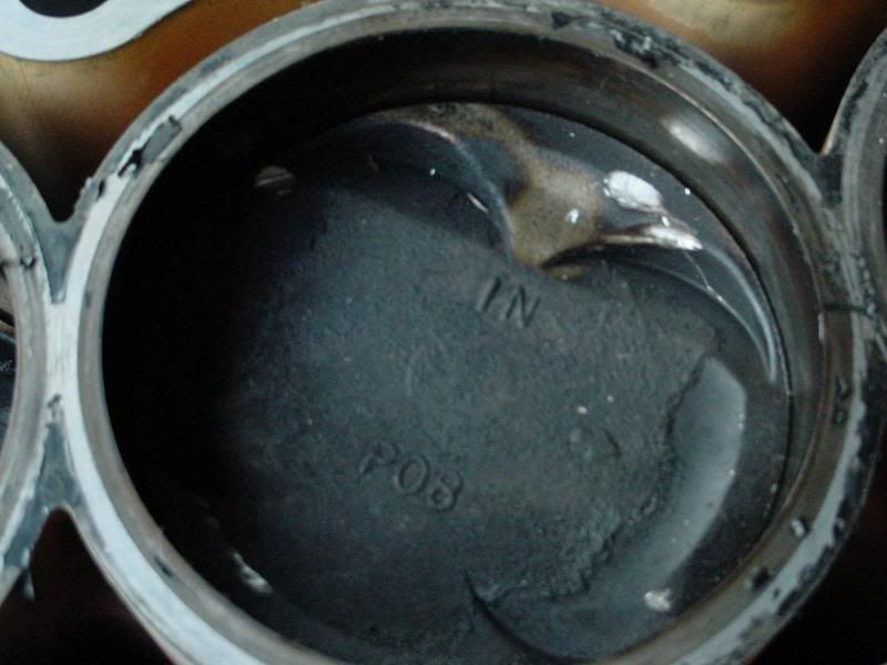

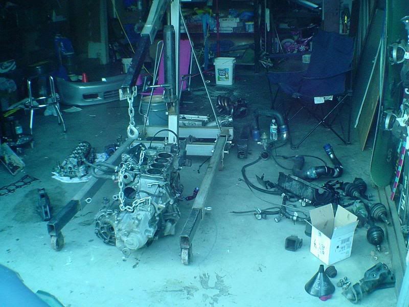

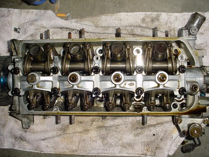

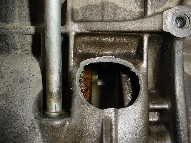

Well, I was testing some antilag changes; little more/less retard and fuel in stages... trying to get a quieter reaction... Well; all the sudden after hitting 1BAR; My boost gauge pegs and BOOM! Shutdown immideately... I mean immideately... And here's the results... more pics to follow; but my smog motor is already in the car, and I just need to pick up oil and put it in the ride, tighten the axle nuts, and away I go. Enojy the eye candy! Image Image Image Image Image Image Image Image Image Image Image Image Image Image Image Image Image Image Image Image

Since the RMC setup was made for power>smog, he didn't care about how it looked, just how it worked. He has a double-port WG actuator on it so it will open during vacuum (bottom port to manifold/post-SC), and open during turbo-created boost (top port pre-throttle body). He used AEM and a boost solenoid to work it, but in its most simple form, you use a MBC to tell what PSI to start bypassing. A one-way valve or three on the vac line would be needed for MBC use. Assuming the actuator has a usable pressure (low as you can get, otherwise it will close the bypass at mid-high vacuum), it will open under almost all vac conditions. Once it sees higher manifold pressure than the spring, it will close. SC makes boost, 0psi in the charge pipes until turbo spools. Once it makes boost, you want to open the bypass. [Don't worry too much about it increasing the JRSC's boost, its efficiency is based on Pressure Ratio, not absolute pressure.] Figure out what charge pipe PSI to open it, tune MBC to match, and you're good. I think the way RMC did it with the EBC is to vent the top port during vacuum, and vent the bottom port during boost. That would allow you to tune how fast it opened, when it opened, and keep leaky one-way valves from pressurizing the bottom port & closing it during high boost. BTW the small bypass will work, but IAT's will probably be higher. Once it becomes a restriction, it is forced into the SC intake, which compresses it. You end up making the SC work slightly, while the turbo works a bit less. It really helps if you think of things in absolute pressure and Pressure Ratios. A JRSC is just as efficient when making 6psi or 16psi, if its still at a P.R. of 1.4 (14.5psi inlet and 21.5psi inlet absolute, respectively). cliffs: wish I could condense this, but I can't :lol:
