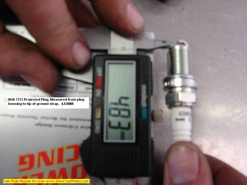

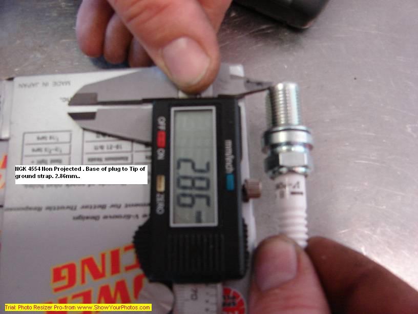

finally.. and sorry for the delay. been covered up with work.. here are the measurements i gathered on the 8 heat range projected and non projected spark plugs. hope this helps.. brandon

sorry your gonna hate me.. I was trying to figure out how far it is form the tip of the insulator to where the insulator meets the base, cause that length is what determines the heat dissipation..
