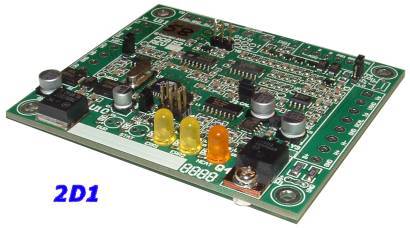

Look at my first post in this thread. Wideband controller is built into the ECU. It even does LSU 4.9 now which is more accurate and has a wider AFR range than the usual old style 7057 LSU 4.2 that most other widebands still use. Near 0 time spent on wiring and much less cable clutter in the car as I tune. /Allan
I saw just the exterior of the ecu, I don't see the interior which brand of controler is it?
p07?
It´s the tech edge 2D0 built into a P28. (picture shows the more recent 2D1 but it´s the same deal) The XLR-like connector coming from the right side of the ECU is the sensor cable. The 2D0 board sits where the knock board would have been in some P30´s. 2D0/2D1 works with LSU 4.0/4.2/4.9 sensors. /Allan

he prob got it from wb02.com in Australia Very much a DIY wideband setup, not ready to go out of the box. People complain about LC-1 for wiring, hahaha Also its quite a bit more expensive than the LC-1, and comes in a raw PCB board format. I'll stick with LC-1 (but that techedge is cool)
i have one here that you buy assembled... And believe me it's good... Way better then LC-1
Yes I got it from australia. If anyone is interested in reselling the Tech Edge products, I know that Peter is eager to enter the US market somehow. If someone wants to, I can make the introductions. Let me know :) The 2D0/2D1 does come assembled though. It´s a product originally designed for an OEM you can use to build into what ever device needs a wideband controller. So \"by design\" it doesen´t have a case. If you want that, there´s plenty of other products to choose from. I looked at the 2C0 as an alternative to the LC-1. It seems like a far better product to me, but it is also more expensive of course. It´s much easier to use, as all connections are made with - you guessed it - CONNECTORS. And not hi-fi old style DIN and DC connectors that fall out just by looking at them. And it has LED´s built in which actually tell you if there´s a fault. My limited time spent with LC-1´s have brought me far more headaches than 3 years with Tech Edge products... no kidding... /Allan
