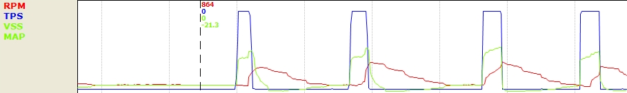

Well; As you guys have known I have been playing with a bunch of different setups... maybe it's just my timidness of playing with tip-in retard, and other ignition related features without having access to a dyno or knock detection aside fromt he butt dyno and 2 ears. ANyways, I have been in need of some more throttle response; especially at lower R's, and am looking for my WOT rev-up fromidle to be a lot snappier. It takes about 3-5 sec to rev up normally... The OEM engine is more responsive than this, but I have seen much better too. Can some of the tuners out there give some insight to me (and the rest of us) about how to get a snapper rev-up? I myself have not found any solid info or advice yet... as tuners are very scarce in my area, and this is a subject in tuning that isn't touched on by many people. To sum it up in my friend's words I am looking for \"Streetbike revability\", but without being excessive on timing, especially as I have a JRSC so I see 6PSI instantaneously. This goes for all driving conditions, but mainly at a stop/idle. I just myself don't want to expirament with too much timing without a dyno, but am interested in some guidelines to follow so I can begin the quest. Thanks!

haha.... ;) Let me explain: Well; let me just say that under 2,500 RPM's, my timing maps are at ZERO for 6PSI; that's the OEM value... and it's gutless as all hell till it gets to near 3K.... you can see the RPM's ramp in the log with IGN; but I myself don't want to blindly add 10-15Deg of timing to the low RPM maps... If I am sitting at idle while not moving; and I stab the gas, it takes 2 sec to rev up past 3K....n that is not responsive in my book. The OEM tune on OEM injectors worked better than that. I have already settled out my tip-in issue; but the tip-in retard tables arent used at idle; so something is amiss and needs to be adjusted.

Sorta; but I am actually seeing 6PSI when I mash the gas from idle... instantaneously.. R's take a sec to climb then skyrocket... here's a screenshot from a log where I was adding timing to the maps to get better response: Image You can see how long of WOT it takes to rev... rediculous IMHO.[/img]

The map is horrible I really don't want anyone seeing what a jigsaw puzzle I am running right now ;) ; but here's a screenshot of the timing I am trying out; by reviewing my log, I have seen a big jump in HP (revability) when the ignition jumps from the 0's and 2's to the 9 deg range, so I have tried basically filling in those ranges with appropreate higher values... I slowly stepped it up to this point; car pulling harder and harder with every degree... didn't seem to peak out yet, probably need to start adding more in some spots. Image No pinging yet (kinda odd since I am running 89 oct), and it has helped some; feels like it is 1/2 way to it's potential. I can definately feel and see a jerking in the logs as the timing values step up during a WOT pull fron near 1.5K in 3rd gear. And I have seen the charger putting out the full .5BAR, instead of just under (5.5-6PSI). When testing this while sitting and revving, I would notice the RPM's pick up sequentially in the after-log as I added the timing thru the RPM range across the MAP range. Side note this probably is reminding me of the 10 or so degrees I would have to add to my maps when I had problems before getting ignition in time. But; my base is correct, and this is different.
