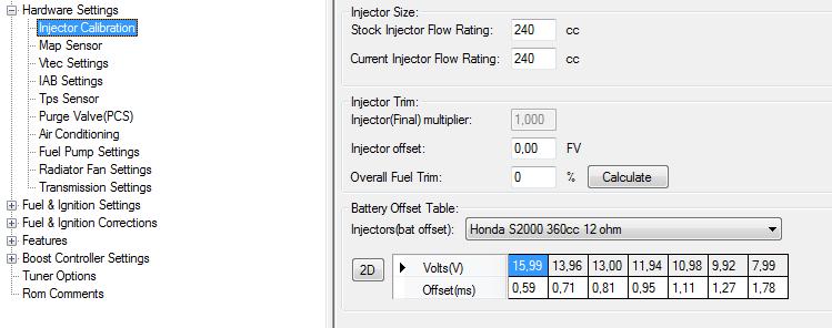

The Cal is there. The injectors are 360 cc

that could be it.. which 360 injectors? if your injector is not listen leave in stock
Yep, for some reason, eCtune always starts the CAL with 0% in the Overall Fuel Trim, not very intuitive if you ask me. put 100% in that box and you should be good to go.

Ok. I do that, but the injector is not the problem. The problem is that there is NO IGNITION FIRE!. I select a P06 becuase this is my ECU, but does'nt work. I do this test; I put another ECU Type (P28) in the ECU type, because the (P06) have a Vtec Convertion Kit and don't work. This ECU Work perfectly with Crome. The emulator connect with out problem and the Hulog. If the are the problem injectorcal the car can start very Rich or lean. in this case Dont'n Start. OK; my ignition don't have the blue wire for the tach; It's there a problem? Somebody have a OBDII B ignition work With Ectune. -Thanks for reply me-
xenocron wrote:Yep, for some reason, eCtune always starts the CAL with 0% in the Overall Fuel Trim, not very intuitive if you ask me. put 100% in that box and you should be good to go.
100% more fuel xenocron? 0% is 0% more fuel on top of everything don't mix it with multiplier 1 multiplier 1 is 0% multiplier 1.99 = 99%

yes you are right, I use multiplier so I got confused :)
