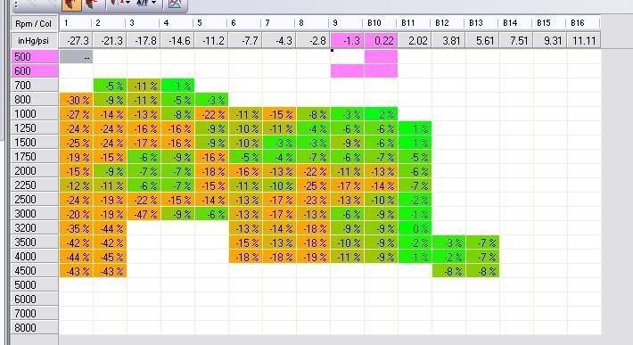

I see, thats what I thought but I wasn't sure. I was under the impression of creating mutiple logs and using those logged files to create a new cal without having to make a run. Kind of like making a master template. But thats not the case then, but all is good. I actually feel excited having my laptop connected on my car without having any problems unlike the shiny program. Any tips on datalogging particularly on filling up cells on the map? I use a braking method to fill up cells during part throttle. I depress the brake while I accelerate and maintain a constant rpm at a certain engine load to fill up cells which seems to work well. Hard on the brakes but it's a sacrifice. Sample log

if your gonna use the braking method, you need to be sure to let it sit for a couple seconds at each load point, or you need to make several passes through the load point, that way you get a good AVG AFR value. Basically the Slower and more times you pass through a load point the more acurate the AFR data will be.
I took your advice and did a couple more passes. It works great!Bugermass wrote:if your gonna use the braking method, you need to be sure to let it sit for a couple seconds at each load point, or you need to make several passes through the load point, that way you get a good AVG AFR value. Basically the Slower and more times you pass through a load point the more acurate the AFR data will be.
