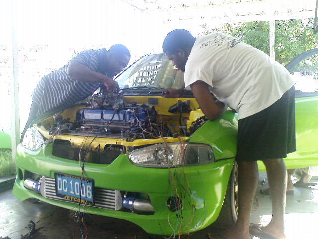

Engine bay being wired up

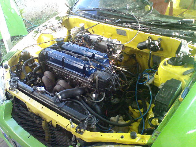

distributor mounted
distributor mounted

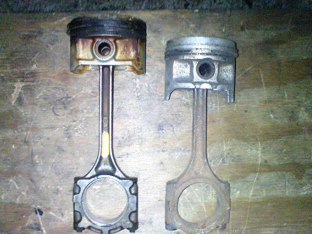

pic of what the 4G94 stock rod (left) looks like compare to D16 rod (right)
4G94  rod vs d16 rod
4G94 rod vs d16 rod
forgot to mention that the MIVEC has high and low cam just like the honda's vtec :twisted: sound the same too :D .... two more days till dyno time :twisted:
OMFG.. look at that bore to stroke ratio... no wonder those 4GXX engines have inherent issues =) Pretty nice work though!
