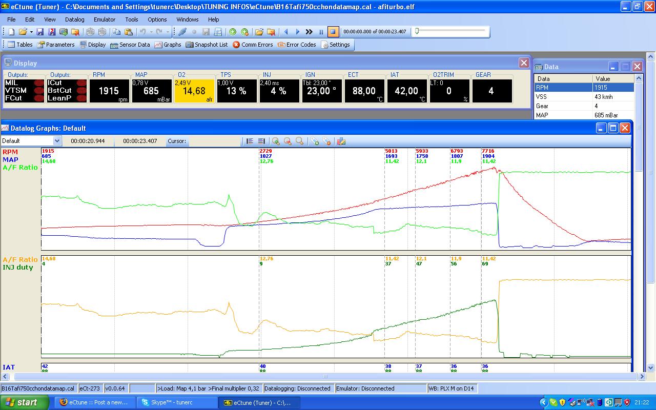

i got one customer with AFI ramhorn turbo kit (t3t04eturbo) on his b16 civic. the car has ramhorn mani, 38mm wg, open dumbtube and 3\" exhaust. I tried only stock WG spring setup and it gave me boost from .7 bar (9psi) to .9bar(14psi). why? will i have more problems on higher boost also?? sceenshot of my datalog is attached

The wastegate is not able to flow enough to hold low boost. It's a function of valve size, exhaust restriction, and exhasut flow to the WG. A bigger wastegate or a better manifold design would help if it's not a desierable low boost curve for your customer. Personally I like boost creep in first and 2nd gear since it gives you better traction from a more gradual torque increase. And no it won't do it as much or at all at higher boost levels since more exhaust goes throught the turbine rather than out the wastegate.
notice the correlation with the AFR line and boost line... but both of them on a graph with injector duty and see how they relate... I think it's the extra fuel giving you a little more spool... and what is a \"stock WG spring\"??? is it an internal gate? either way... what is it _supposed_ to be?

here's a B16 with the same turbine and same wastegate with a .7bar spring. It creeps from 9psi to 11psi by redline. There is a rich spot at 6200 rpm but otherwise the airfuel was flat in vtec. I have seen this on lots of B series with small wastegtes that come off the manifold at almost 90 degrees like your AFI one. Image

Today i've tuned the car. it produced 350WHP at 20psi, measured on a mustang dyno. Boost wasn't stable neither at higher boost levels. But what can i do else than to tuned it like it is. Thanks for help, people. It seems that a problem comes from too small WG.
