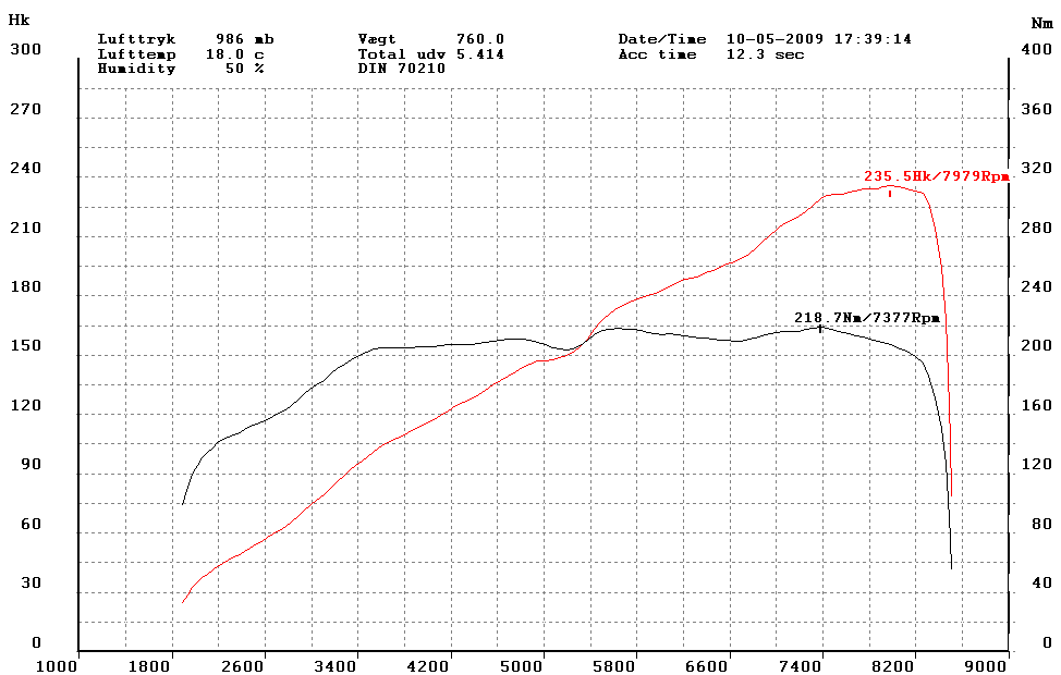

This is a recent dyno run. 200-220 Nm from 3400 until limiter. Naturally this is not a quartermile beast, but for other purposes quite ideal :) /Allan

I've read the flow map and did some calculations based on my engine @ 6psi. I have my doubts about the high RPM range at low boost (less then 9psi) Can it keep up with the air flow above the 7k RPM? flow map and torque graph both show a decrease of efficiency. But on the other hand, we're talking a daily driver here, so 7K+ is not that important. And the torque graph still show 200+Nm. hmmm.... dilemma!!1 :D
